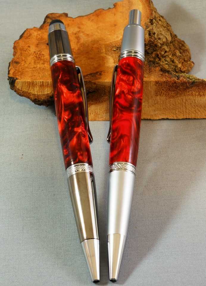

Sometimes there isn't enough pearl color in blanks. This can almost always be remedied by painting the inside of the blank. That may or may not fall into a warranty issue. Personally, I'd replace the blank if I thought there wasn't enough pearl in the mix. But that's me. I will say that some colors are just more translucent. Even with plenty of pigment, the brass can show through, or change the color.
If the blank was almost clear with other colors that are more dense, that's another issue entirely. Some blanks are just more clear by design, and have to be reverse painted. In those instances, the blanks should be marked as requiring to be painted for best results.
I don't think you have to go overboard trying to match color. Something close almost always gives a good result. Sometimes adding a darker or lighter shade will enhance the original blank even more (I realize this is subjective).
Attached is a picture of two pens made from the same blank that I cut in half. One I painted the inside of the blank red, and the other black. The blank is clear red mixed with a pearl red, so painting the blank was required.

I know it is a bit off subject, but can I ask you Bob, where do you get that red pearl pigment? I have been trying to find that color, and cannot.
The color is called metallic pearl red raisin. It was sold by Coastal Scents. But you may or may not know Coastal no longer sells mica powder. I will tell you that the red pearl is a little darker than it looks in the picture. I think the translucent red dye helps lighten it up.
You're probably looking for a bright pearl red. The best way I know is to reverse paint the plank a color closer to what you want. I know the pen on the right was painted with a bright red paint.
