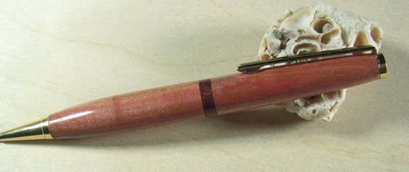

This one was made from a bubinga blank that blew up on the lathe, so already had the brass tube glued in. I cut it down with a parting tool, then cut the brass with a razor saw (Exacta hobby saw) and sanded it flat. Do you make them with the tube in, or just drill a mandrill-sized hole in the wood and go from there? I am guessing that the tube makes it stronger. Also, I glued the ring to the upper pen barrel, figuring it would make it harder to lose.
The pen is a "fat" slimline, pink ivory, CA/BLO finish, buffed with white diamond. Apologies for the color balance, not yet right in the photo - I'm still working on it.
Second question. do you see the color banding in pink ivory often? This is only the second one I have turned.

Eventually you will find your own method of making CB.I normally part off the material and add a "fake one"
AS for your question on the color band in pink ivory I don't think it was in the wood before you turned it.
YOu may have overheated that area while sanding, not sure of the cause but it doesn't look natural to me.Too uniform and goes opposite direction of the grain.

I agree with Eagle. Bright or dark uniform rings are rarely a part of the wood. Sanding heat is usually the cause, and a result of sanding too fast and holding the sandpaper too long in one place. Slow down the lathe for sanding, and always stop the lathe and sand with the grain between grits. They can also be caused by bruising the wood with dull tools and/or too much pressure on the wood, again from getting the wood too hot.
Having said that, sometimes these things are a part of the wood; but you will never convince anyone of that. Whatever the cause, when such things happen to me, the pen never gets put together.

Re: the color band. All that is possible, though I do try to use very sharp tools, and sand at abut 500 (about as slow as it gets). For this particular pen, I sanded with the lathe OFF, with the grain, until I got to the MM, and I don't press very hard with that. Best possiblity I can think of is maybe burnishing with the paper bag, or the final buffing, where I probably pressed pretty hard. Anyhow, thanks for the heads up!
