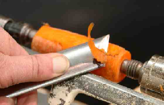

If you can peel a carrot, you can use a skew.
Put a short piece of a latge carrot between centers. With the lathe OFF, make a peeling cut as shown in the photo. Now turn the lathe ON and do the same thing. You have just learned how to use a skew. Now do it with a piece of wood.
Now in the picture you are using a round skew. I have a flat skew. Is there any difference in technique?

Russ is also using the "long end" up, it can be used either up or down, I prefer down. BUT, his analogy is GREAT!!!!
The difference between an oval skew and a square one is how it rides your tool rest. The square will get caught on "nicks" in the tool rest more readily than an oval skew.
Both tools work GREAT if the tool rest is perfect!! (They can be sanded or filed, if they get nicks)

The carrot analogy is hilarious but effective. Alos notice the area of the knife that is making contact with the carrot. I only use the skew like a scraper when making pens but I have used it on other turning projects and enjoyed it. It seems when I start to use it on smaller diameter pieces like pens, I'm not as "good." I say that in quotes because I am new to this lathe thing and can't expect to be at such an early start. I guess the keyword is practive.
