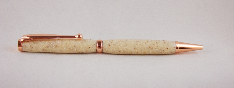

The first 50-75 pens+ were made from corian, I found that I just had to take a little more time. I often used a round file on the inside of the tube. I did this until the fit would not stress the blank. I almost always glue components in on most pens. When pressing together I would go very slow and make sure that the blank and the component were perfectly aligned. If a blank did crack I would disasseble, reglue, turned slightly more and refinished.

In my area there are alot of contruction companies. I think that the main reason is that it is a material that they would not expect on a pen. I have about 100 colors of it and most look like stone. it did help to that when I started making pens I did not have a large budget so I looked at the materials that gave the best amount of product that looked good. I bought 400 pieces 1/2 x 1/2 x 5 inches for $40 counting shipping it allowed me to make more mistakes cheaper than other materials with a nice high quality pen
The picture is one of my early pens made from Corian, it is one of the uglier colors I have most look better
