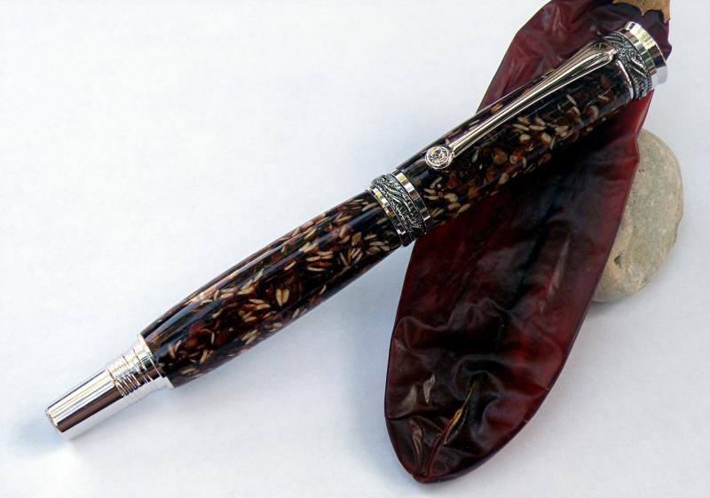

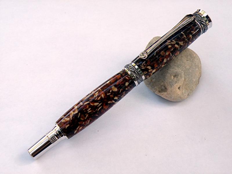

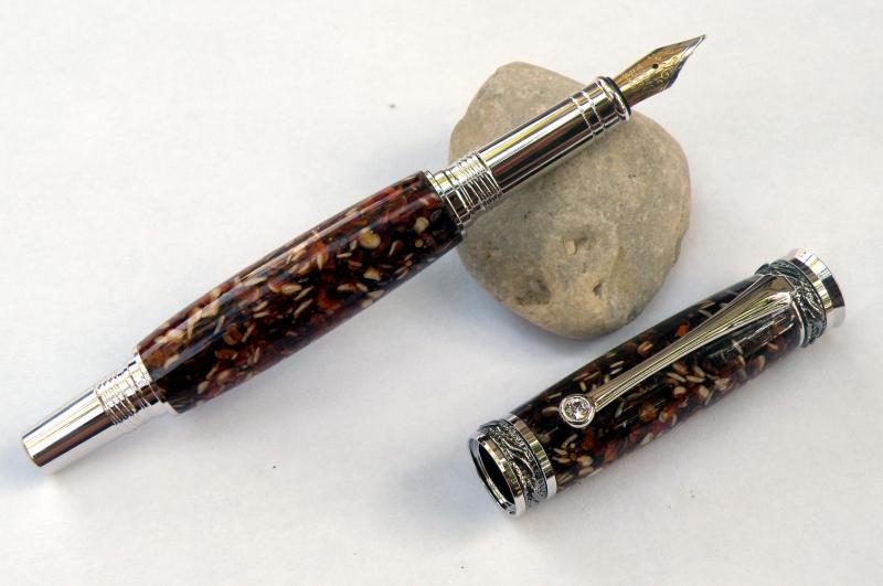

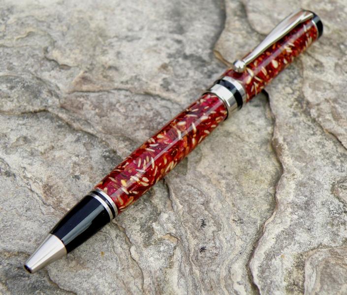

Dried red peppers were used in this blank from Dawn. Placed on a Jr. Majestic set as ordered by the salsa making customer. A bit of CA to fill the voids and 10 coats of CA for a finish. The inside of the tubes were painted black. I used my respirator and had an open window for this one. Just when sawing it, it felt like the shop was getting sprayed with pepper spray. Added another pen I made a month ago from the same blanks. This one was painted red on the inside.

Nice job, Eric!!!!
Pepper blanks ALWAYS have some voids, you did a fine job of filling and coating!!! Your close up looks GREAT!!
Hope your customer appreciates YOUR expertise in making this beautiful and unique pen!

I like really that you painted the tube black. Definitely gives the pen more depth.... more of a roasted pepper look. :biggrin::tongue:
