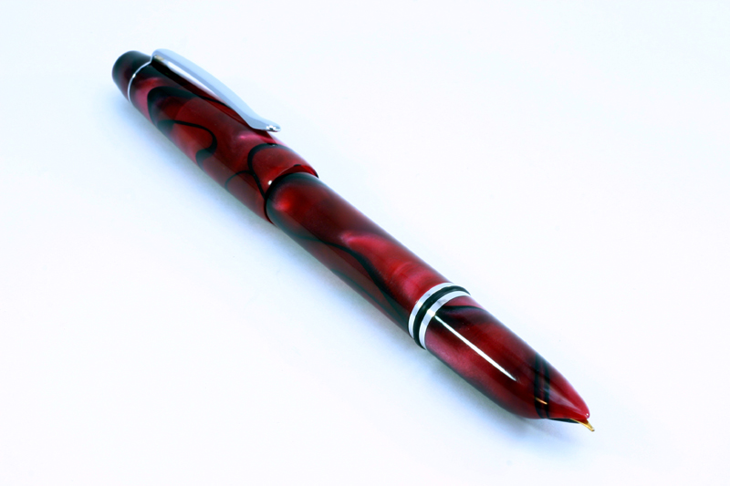

I have had an picture in my head for months now of a hooded nib pen, and decided it was about time I laid it to rest!
It was quite a challenge, but overall I am quite pleased with it. There are a few bits I would do differently, probably narrow the front near the nib, and make the cap a bit fatter with the possibility of a metal band right at the bottom of the cap for strength. I would like to use sterling silver as I'm not keen on the way ally tarnishes.
Critiques and suggestions more than welcome.

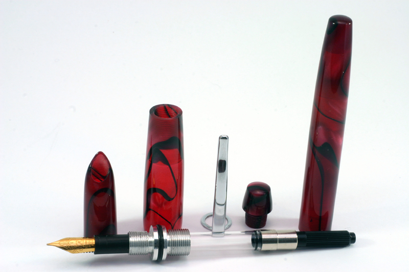

Very cool pen. I like the centre connector (?) that serves to accent the barrel too. Clever. :good: The friction fit cap also great. It will be hard not to incorporate some of your ideas in future pens. Thanks for letting us see it.

Great idea. I have seen a few in production pens but not in a handmade kitless. I really like the colors and the shape. The only thing I don't like about a lot of the kitless pens is that they are see through. Beautiful pen.

Thanks really good! Very professional looking. Not only is the hood well done but the addition of o-ring for the friction cap is great as well. Looking forward to seeing more. I bet you could raise the bar by using ebonite or one of Johnathan's blanks (for more flare). Great work!

I too really like the friction cap with the o-ring. That's the 1st I've seen like that. I also like the connector, and that would really be cool in silver.

This pen is a GOOD thing. The o ring makes me smile and remember the "clutch" fit of the Parker21s that I was always so fond of. You took an element from a classic and added a level of elegance.

Now that is slick! Yup, I think Butch would be proud. Very nice job on the connector. Well done.

I've had a couple of members ask about the centre connector. The threads are M9x0.75 on the section side and M10x0.75 on the barrel side. The thread for the feed holder is M7.4x0.5.
