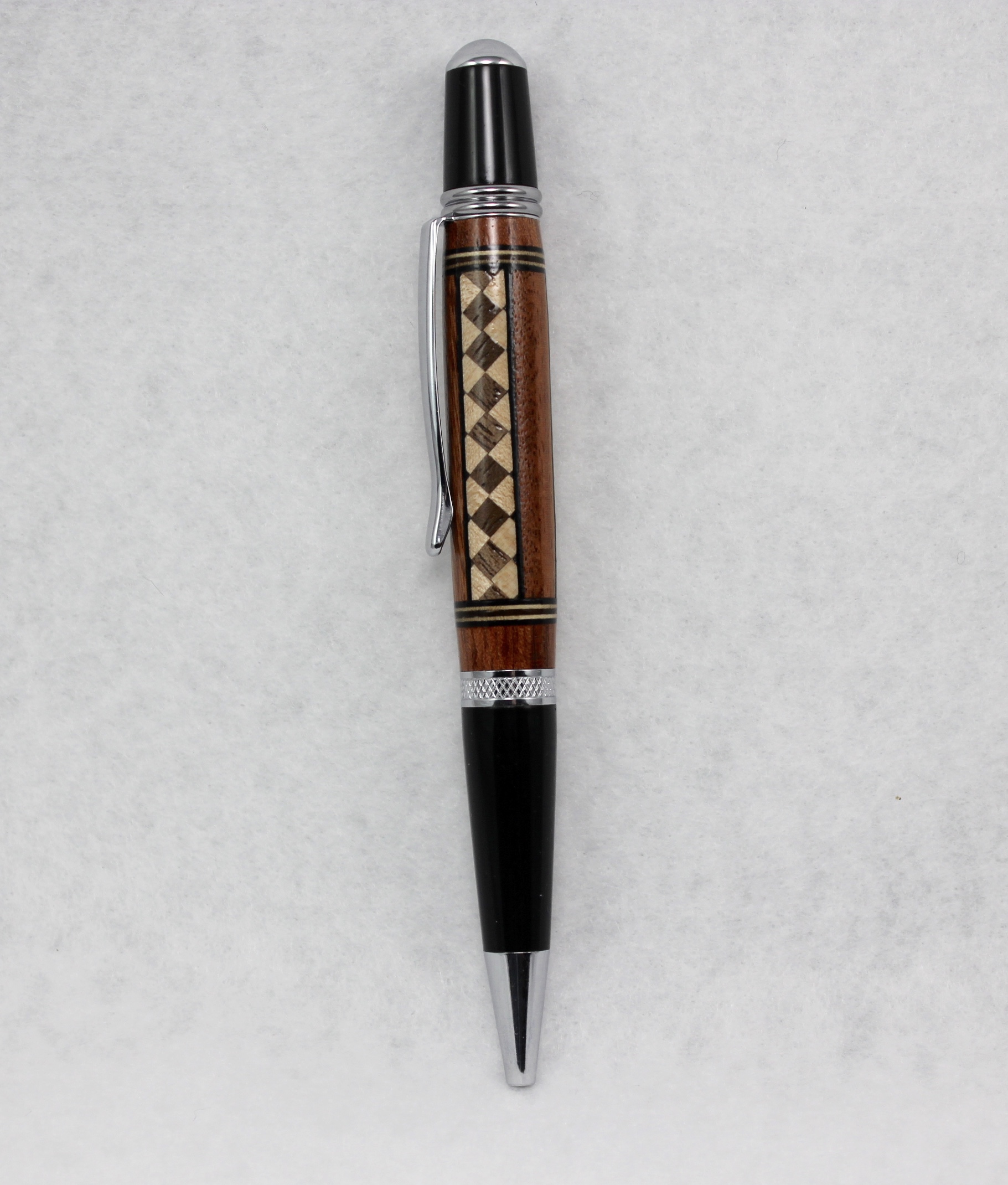

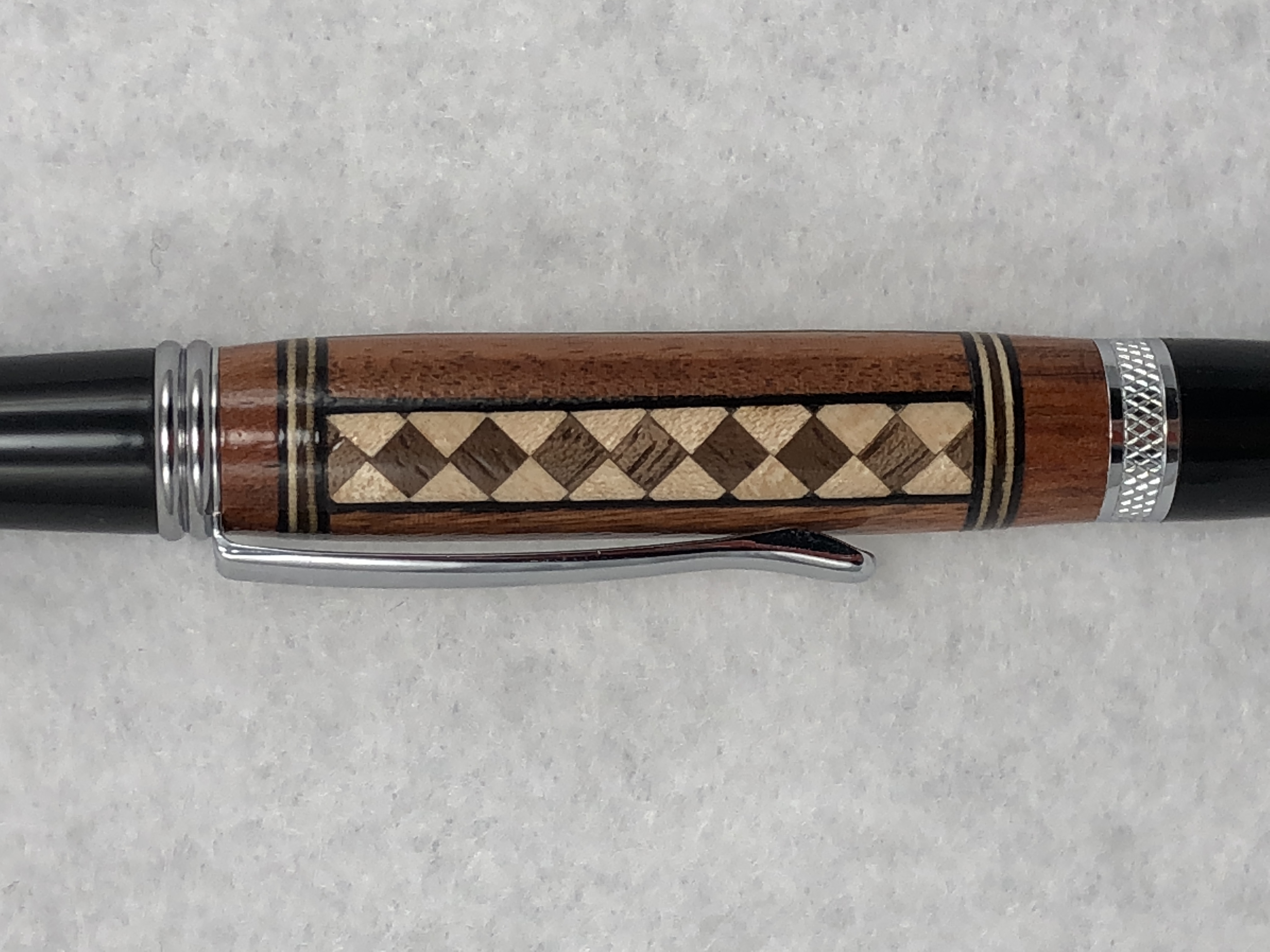

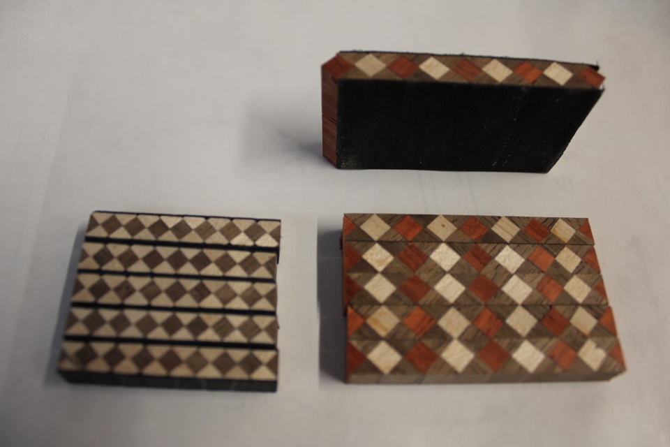

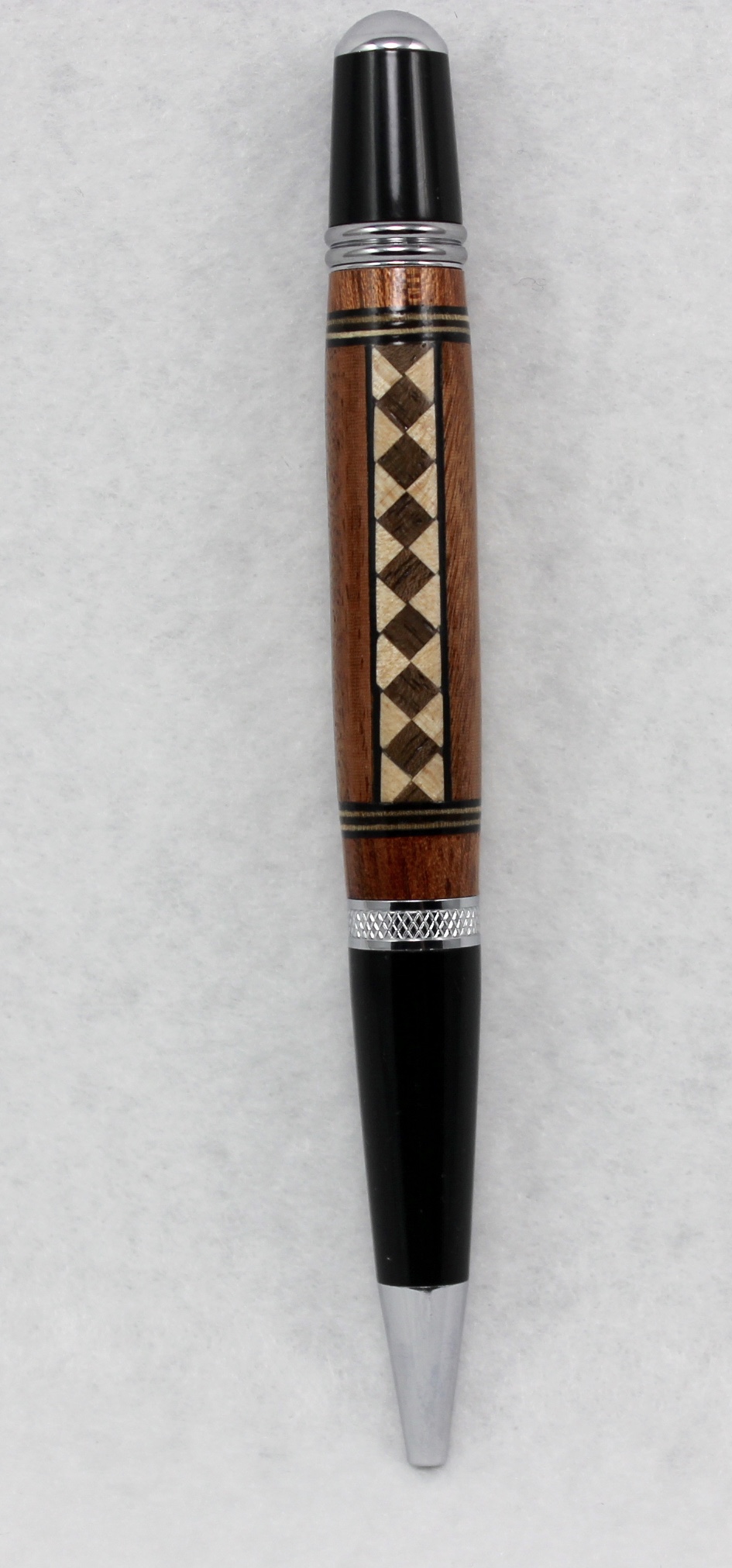

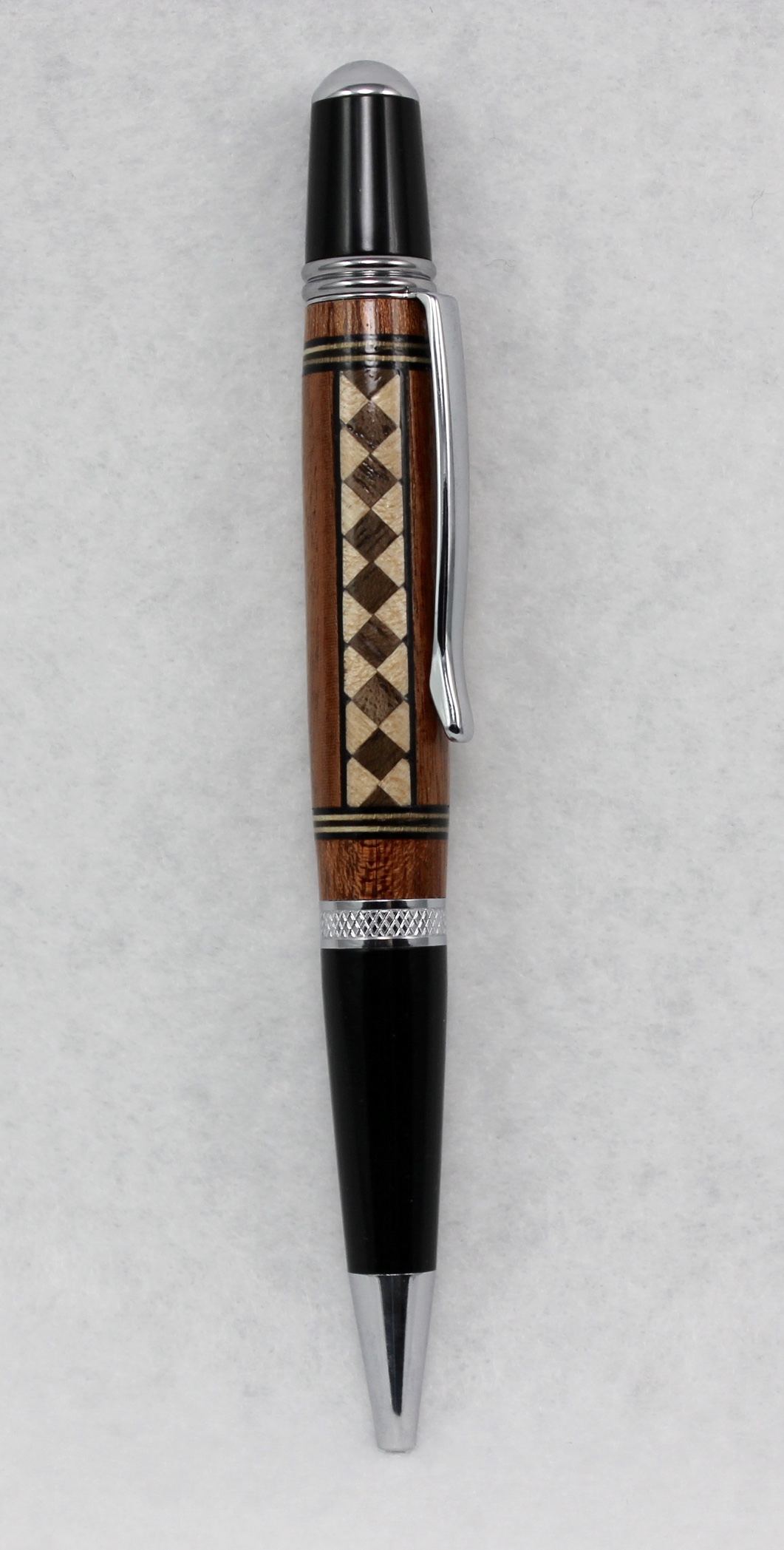

My first successful attempt at this design came out OK (Diamonds), but I wanted to get the pattern thinner to avoid the need for a 2-sided appearance.
The first inlay (2-sided pattern, previous thread) was about .352" thick. This 3-sided inlay is about .265" thick for each section. I just needed more practice getting the triangles smaller, the diamonds/squares were not the problem.
The 5 layer bands were supposed to duplicate the Black/Maple/Walnut/Maple/Black theme for the inlay, but you can't notice the middle being walnut vs black. And I screwed up sizing the end caps, but I'm still happy with the results.

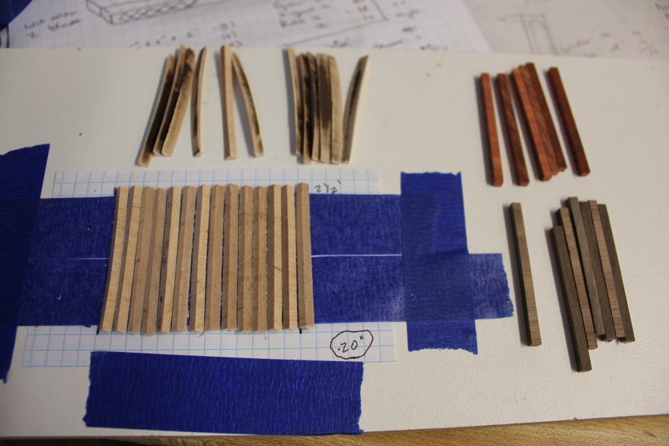

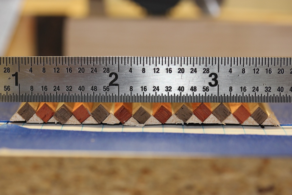

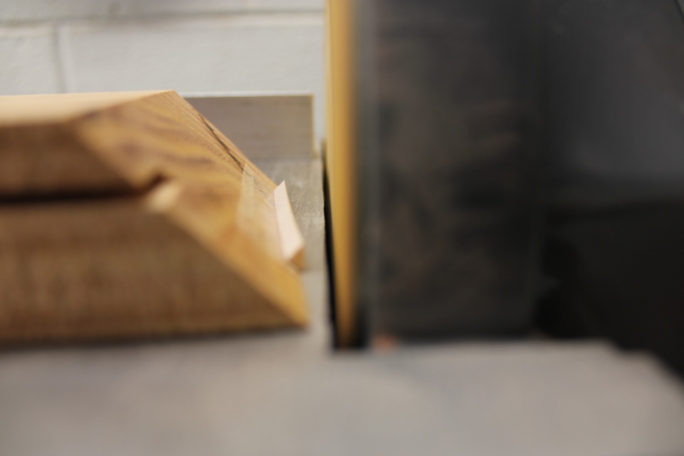

Hey Mark - Really impressive. Is your eyesight good enough for this teeny detail work or do you have a good set of magnifiers.
Ed
Hi Ed, actually my vision is 20/950 and 20/1000, with slowly developing cataracts. I usually take my glasses off and just get to 2" from the pieces if I'm gluing the segments. So far I have not glued my eye lids yet.
My hands are getting more shaky, so that is more of a concern.
I'm just sanding the triangles down, so no need to get too close.
