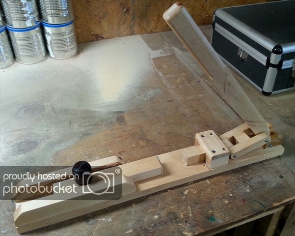

Here's mine:
I initially made one similar to the peg adjustable ones previously shared but it broke. I find this to be a much sturdier design.

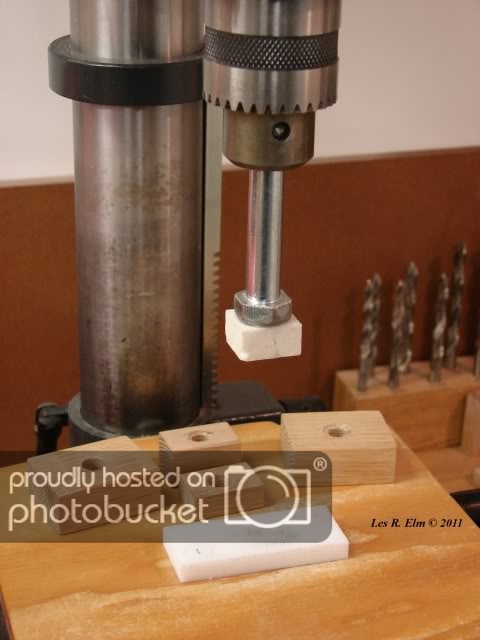

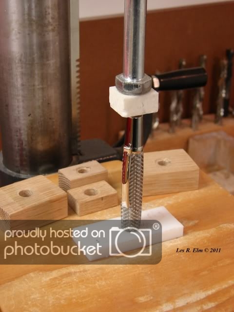

I turned a scrap piece of oak to fit in my drill press and I use that to press my pens together. I think corian would work better, I just don't have any laying around.

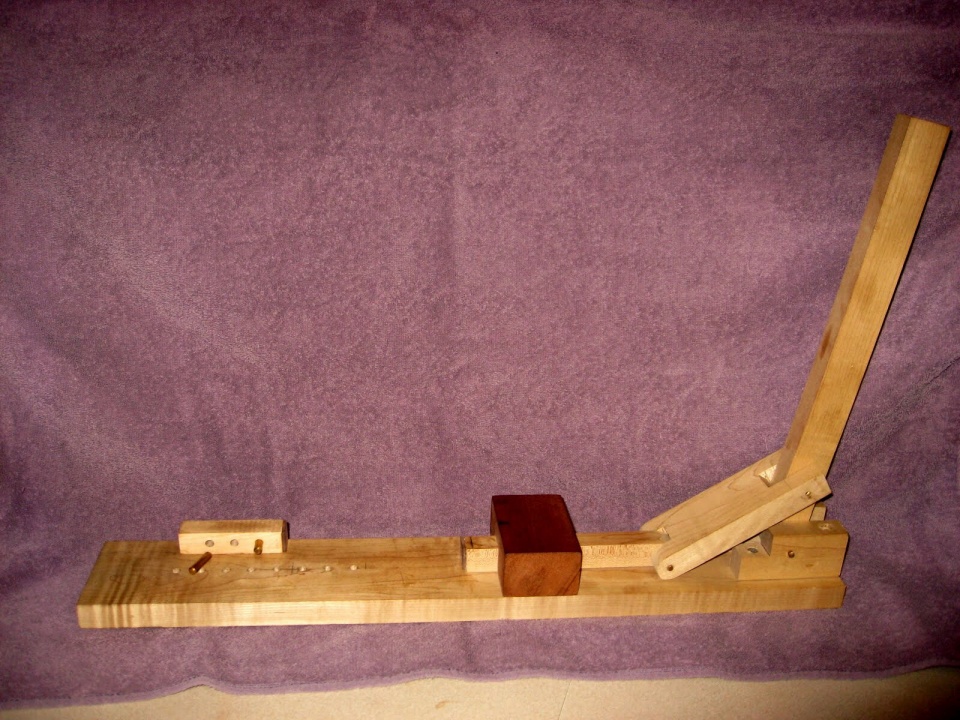

I made the same one that Lenny posted. I never did like using it better than the wood handscrew clamp that I started with and have always used since. If you would like my press send me a PM with your address and I will send it to you free. If you are really looking to build one I would say it is a good plan.

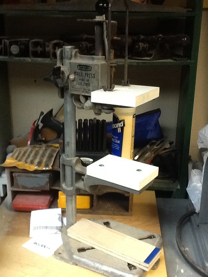

My homemade pen press consists of 2x ~1" long pieces of cherry faced with plexiglass. One goes in my headstock taper, and another in the tail stock.
