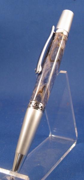

This is a piece of heavily spalted sugar maple that was dyed and stabilized by me. I am pretty happy with the stabilizing and am going to keep working with this stuff. The kit is a 2 toned chrome Sierra and the finish is 6 coats of thin CA and a quick buff followed by a coat of Ren wax.

Neil, that is one beautiful pen. Wanna share how to?
Sure, first I mix a bunch(mathmatical term) of plexi into some Acetone and let it melt, then I put the wood in and vaccuum it until my pump dies. I let it sit in there until I buy a new pump(about 6 weeks) and then kept it under vaccuum for another week or so, and when I pull it out, I turned it down and then soaked it in RIT laundry dye. after that, I sanded it again and slapped a CA finish on it.

Awesome job Neil. Just out of curiosity, what does the cost of the blanks come out to after using a pump per each cast? On second thought, don't tell me, I'll just admire the blank. Really a nice looking blank.

On the rit dye did you use the powder mixed with water or the available liquid formulation?
I would think either (neither?) would have a hard time getting into the wood since you did the plexi first. Ever try it the other way around?

Beautiful Neil! So you stabilize first, then dye. Do you not let the stabilizing material dry before you dye? I'm not sure how you got it to penetrate. And you use only vacuum?
Just curious, but it is lovely. Oh, one more thing. Only 1 color dye or a few? That's really pretty.
Do you guys that do so much of this so well not understand people would PAY for books on how you did it?!!!

I did dye the wood after I stabilized it just to make sure that I got the color into the wood, I guess I was thinking a bit backwards, but it worked. The dye was the liquid concentrate and it works very quickly. Home stabilizing doesn't make the wood into one solid piece like the commercial stabilizing does, so there is still plenty of area to catch the dye and hold it. I have also successfully dyed some of this wood by pouring a little dye on a piece of paper towel and rubbing it on while it is spinning on the lathe.

The mixture that I am using is pretty watery, I figured it would penetrate better that way. I will give the pressure afterwards a try and see what happens.
As long as I am using a brand new pump and there is no warning on it not to use it for this, I guess they will keep giving me new ones every 2 months....LOL Seriously, if it is damaging the the pump, I will know soon and switch over to the venturi pump. I probably shouldn't have given mine away, but I can get another one.
