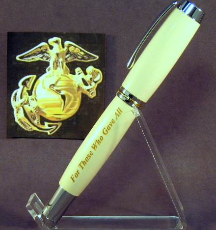

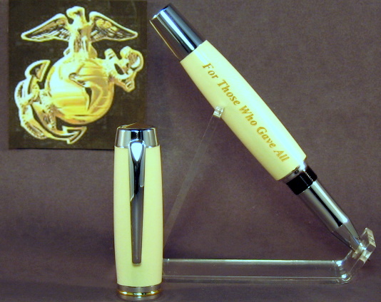

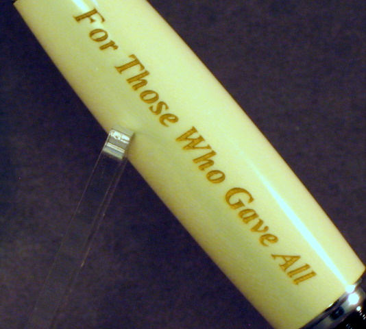

I made three or four pens with CA finish. Gave a couple to some friends in the service, and have one for myself. It is still holding up well after four years.
