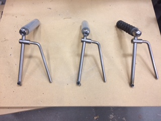

I make these for small hollowing.
Lin.

Lin shows a picture of his version of the Don Derry hollower. That style works but has a more narrow range of sizes. The out rigger helps.
