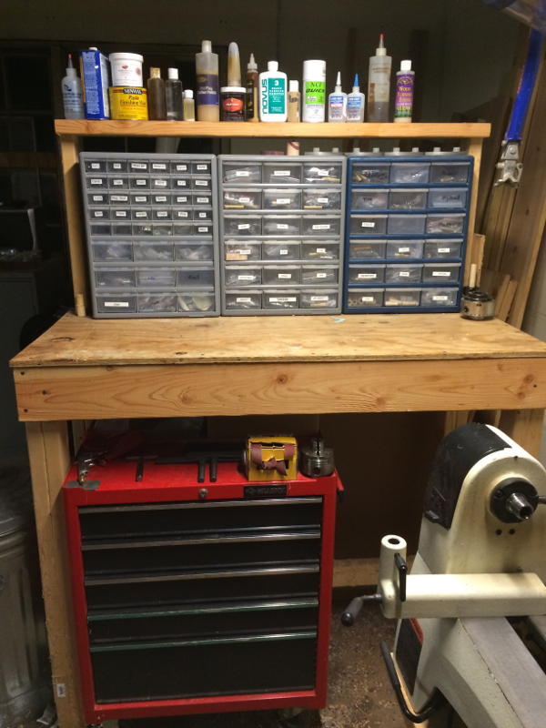

I'm not sure how you guys keep up with which drill bits & bushings go with various kits. It appears there are many sizes, so you must create some kind of filing system to keep it all straight.
Thanks All!

I keep my bushings in small drawers and kits in the bigger ones.
