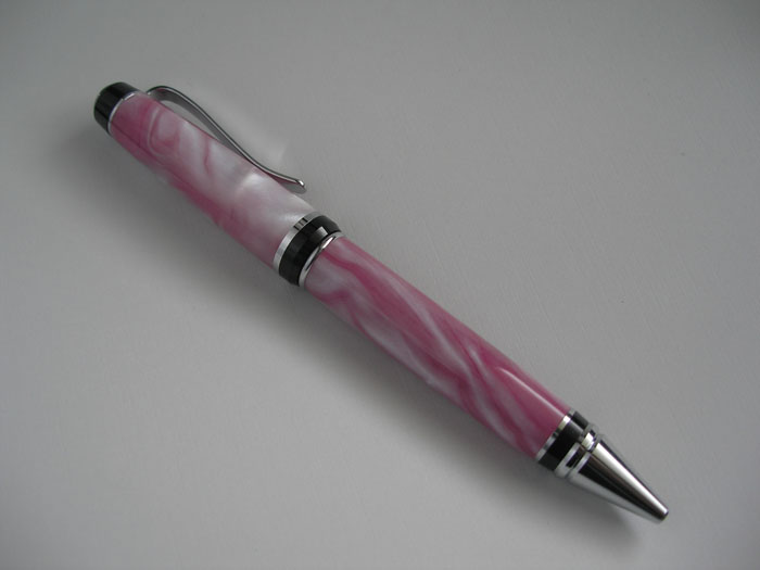

I was looking and finally found this picture. It shows what painting tubes different colors can do to the finished pen. On the left is CSUSA Amber Marble with the inside painted yellow and the same blank on the right painted red on the inside. The Cigar pen is a blank from Woodcraft Sugar or Opal or something that's painted a rosey pink inside. I do a lot of these as perfume pen and paint them different colors inside. I call them my Glacier Series.
