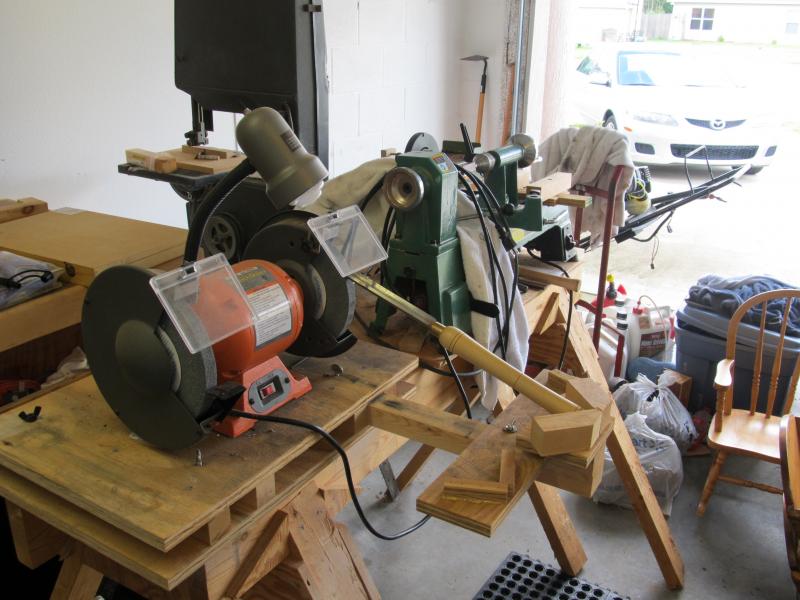

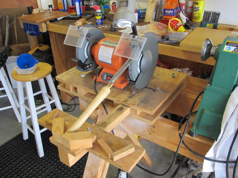

I have been using the 8" for almost a year now and am very satisfied with it. I have had no issues. The grinding wheels may not be the highest quality. But I have not felt the need to replace them yet I am able to get a plenty sharp edge with them. I have a friend with the 6". But he has never made the sharpening station for it. So I can't say anything about it.

Ed, your sharpening station is very good looking. Do you have any plans available for it? It would make a great addition to the library.

I just bought the 6" grinder with the light and changed it to a buffing station. It works great for buffing. The plans for Ed's sharpening station i bought off a web site through "utube" for $5. It works very well. You put marks on the main board so you know where to move it for different tools.
Charles
I found the plans on the following web-site.
http://www.finewoodworking.com/pdf/ShopBuiltJig.pdf
These are also helpful
http://www.youtube.com/user/johnrob281#p/c/01A590EC158DC841
http://homepage3.nifty.com/manasan/english/diy/diygr70.htm
http://aroundthewoods.com/sharp.shtml
I also made an attachment to sharpen my scrapers. It is just a flat platform that I clamp to the front. Would go take a picture, but my wife is making me help clean the house:(
