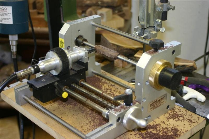

Here is the webist for the Legacy: http://legacywoodworking.com/
Other similar machines are available but out of production. I use a MillLathe, others use the Sears Router Crafter (whick goes by another name in the UK). Beall Tool Co. makes, or once did, a tool called the Lathe Wizard (I think) and Nova also makes a similar tool. Ebay is a source for some of these but you will need to look for them on a regular basis because they are scarce. I will try to find the name of the UK router crafter...which is also out of production.

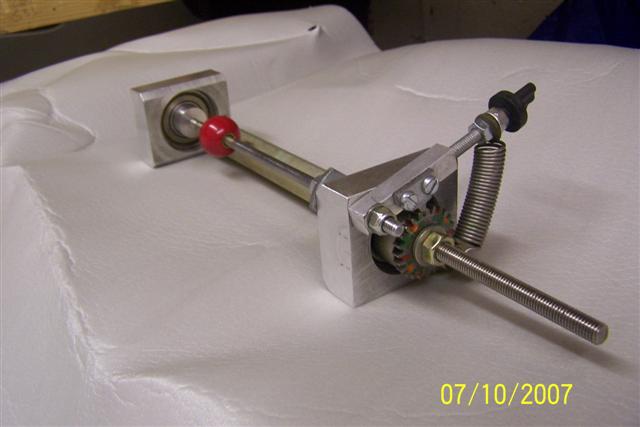

Here are two prototypes of my newest homemade gadgets. The first one will only do flat milling, it is fitted with a 24 tooth gear for indexing. Simply mount this on top of the compound table. The second one which uses the same 'mandrel' from the top one, does spirals as well as flats. My small router mounts on the block in the middle.
Sorry but dimensions of these would be pointless as the gears are from a rare bit of old switchgear from Norway[8D]

Blimey skipRat this is impressive. Perhaps a compound table (thanks for the heads up on that) mounted on my expencive Jet pillar drill with a milling bit attached would do it.[8D]
I like the idea of a 24 tooth gear to get some sort of equality on each side.
I am only intersted in milling the barrel and cap not altering the kits however your hexaganol pen is superb.
All I need is a mandrel holder like yours and I am there. I think I could build something like that.[:)]

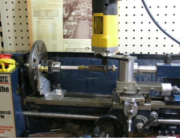

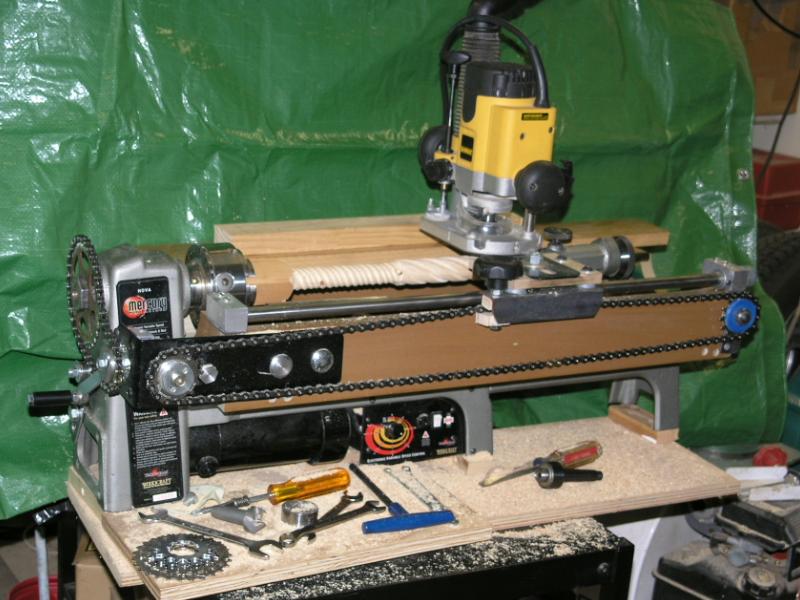

Chuck Key
May 3, 2005
1,596
Richmond, Virginia, USA.
Apologize for the late reply just got back from spending the weekend at the North Carolina Woodturning Symposium.
Here are photos of a couple that I use and a link to somethin you that might work with some adjustments.
Metal lathe solution:
<br />
Wood Lathe solution:
<br />
Standalone solution:
Follow this LINK.
Chuckie

The Trend is the one I was trying to think of that is the UK version of the Sears Router Crafter.
The MillLathe that I use was indeed sold by Woodcraft but the marketing was not the best. The basic MillLathe was sold as a pkg and all of the other things needed to sprial, index, cut flats, hold different tools, etc were sold as individual kits. It should have been sold as one complete system. They are scarce but they do show up on eBay occassionaly.
A used Trend should surface somewhere in the UK...keep watching your UK eBay. I may know where one is over there. I'll check and see if it is still available.

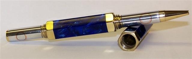

Hi Andy, sorry for being a bit late with this reply.
The following picture is of a pen I made for a bit of fun, from an old hexagonal piece of hollow plastic rod which was the angle adjusting rod for a venetian blind. Sorry the picture does not do the pen much justice my photo skills are just developing.[;)]
The kit is a gold slim line from CSUK. Finish is my own mix of wax buffed on a "Paint Roller Buff". The finish is a high gloss but it does not show up well in the pic.[:I]
