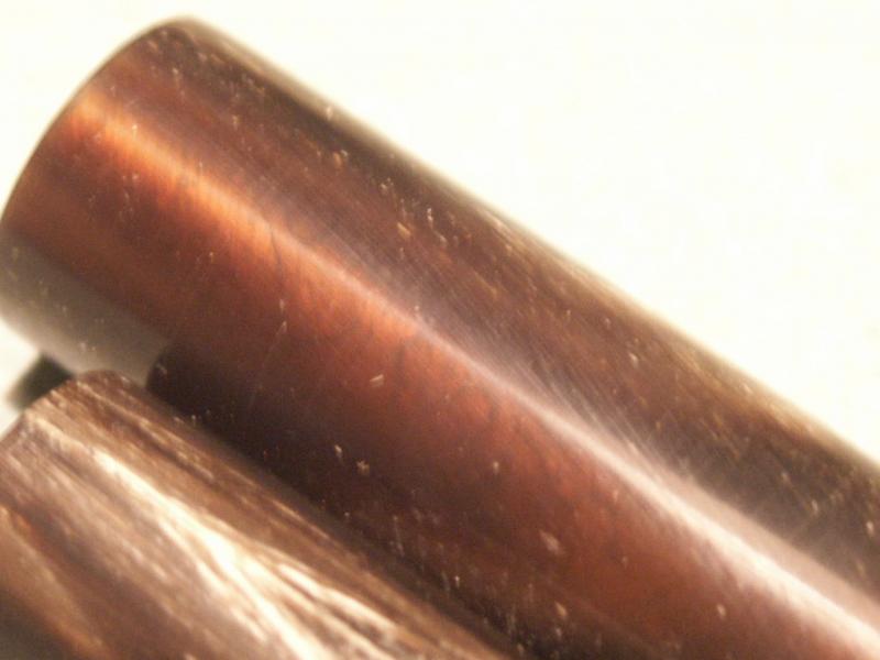

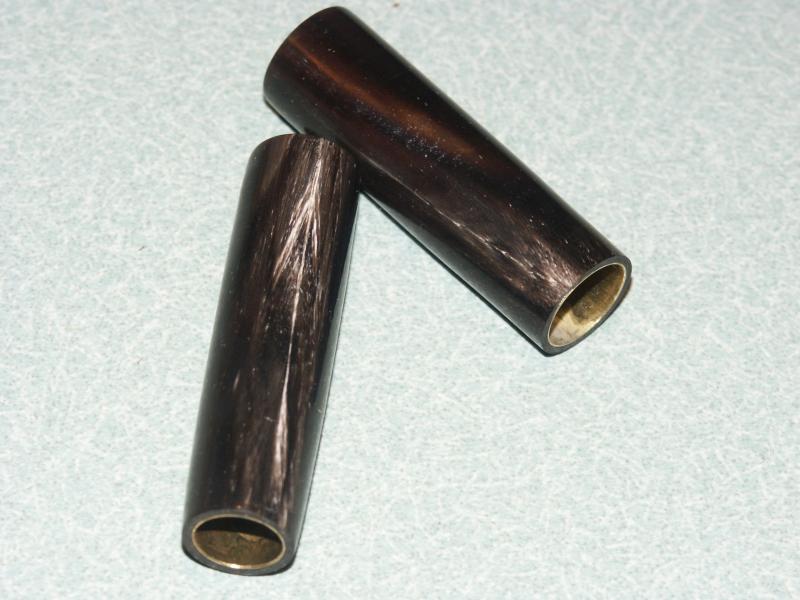

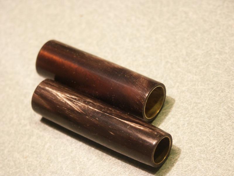

I just turned, and polished some for a Jr Gentlemen's II
I had no problems turning them, However I am not happy with the results. I didn't think that they would be transparent in places. I didn't paint the tube, so now you can see the brass tubes in places. Other than that they turned out nice.
So I think I will just try to talk my friend into a different material for his pen.
Thanks anyway.

Lubricate the bit as you drill, go slowly! Heat is your enemy. I would not soak horn as it can get too soft if your not careful. Horn is made out of the same thing as fingernails, chiton so it will be translucent. No need to do more than polish it.

The brass tube does kinda kill it a little. I never paint my tubes but I think its time to start. I guess you never know when you will have see through spots on pens. That's a bummer I know.
