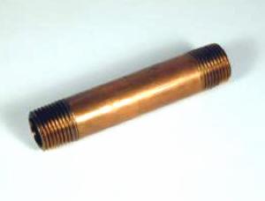

Joey - would be able to give me a link to one of those water nipples so I can picture them in my head. The reason is that I am trying to source untreated ones so I can do what you said but the only ones I can find in the UK are all threaded with a coarse thread it seems. I know absolutely nothing about pipe work! God I feel a little inadequate....

I could explain a nipple, but would probably get kicked off here, so basically it's a hollow piece of metal (brass or steel) with a hexagonal section in the middle and a thread on either side. Used to connect various fittings together, used for air, or liquids.
I buy the 6" length and cut it in 2" sections, the reason I do this is because I don't have access to a brass tube supplier locally. Now the purpose is to be able to make a thinner pen without breaking the threads, also I'm a big fan of segmenting so I use to support the wood, This is my wife's pen
