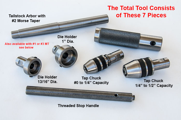

I just picked up this. Wow it works great
