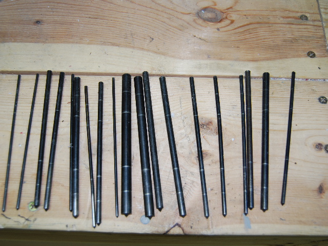

I agree with the suggestion of disassembly. I have a set of (punches?, not sure of their origin, they were in my late fathers tool boxes) that i use to disassemble mine. I have a set of rubber jaws for my vise that i lock my pen part in, and use the punches to remove the nib, and then the tranny.
Those are transfer punches.
Thanks for the verification, I kinda thought they might be.... but wasn't sure. Theres still one more complete set in one of his tool boxes that i'll have to bring back with me on my next trip to see my mom.
