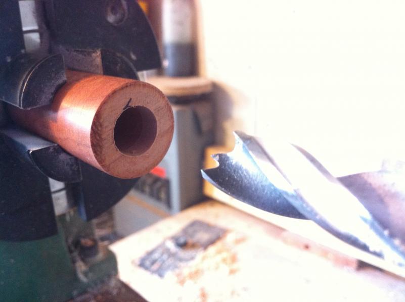

I drill with a similar 4 jaw chuck using pin jaws.. As long as they are straight the work pretty well...There should be a set available for your chuck.

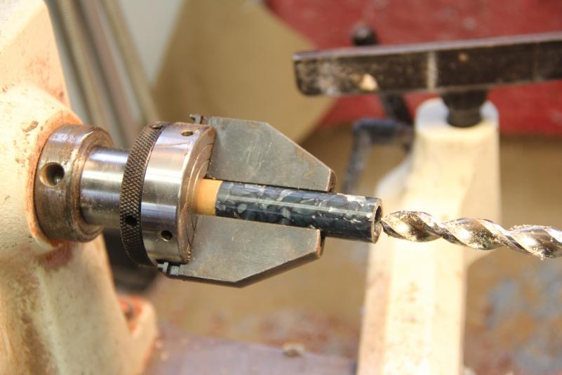

As others have suggested/recommended the PSI chuck is a worthwhile investment. I primarily drill using one of my drill presses, care in set up, take your time, sharp bits, all keys to success. Ditto on lathe drilling. It makes little difference what tools a person may choose, I believe in the KISS principle. Regardless, improper set up, dull bits, getting in a rush is clear recipe for failure.
A friend, a highly respected pen designer, and turner added that lubricating your bit will go long way towards ensuring success on both drill press and lathe. His recommendation is PAM, yep the stuff your mother sprayed on her frying pan. I've also had success with water combined with a little dish soap, in a spray bottle, Dawn works for me.
Photo is PSI chuck with piece of Italian celluloid. At only .651" diam, this material costs too much to waste, and melts at very low temp. Don't ask what temp, i don't know and its not important. The lesson is set up, sharp bits, lubrication, patience.

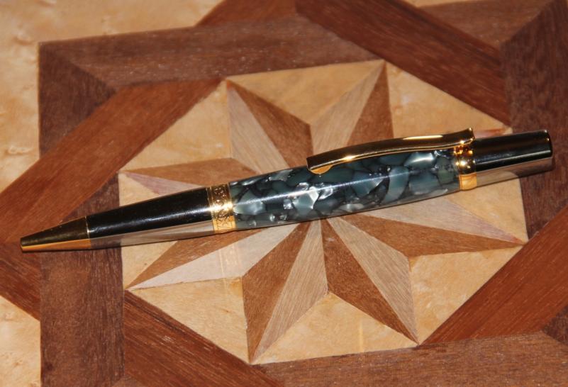

My ipad will only post one pic per reply. This is the pen from that piece of celluloid.
