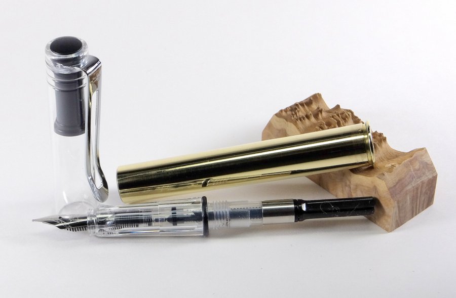

Hi mate a while back I bought a number of pens from China direct so I could use the parts ,many were clear. Glued a threaded piece in the cartridge. No Idea where I ordered but Google was my friend,cheap as chips and may fill your requirement.
Kind regards Peter. PS JINHAO ON E BAY FOR STARTERS (free freight).
