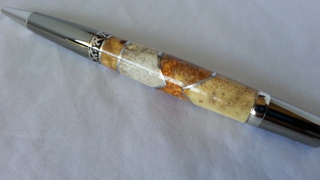

I have a 3:5 success rate with sandwiching. Used both glues and sharp bits. The biggest detractor I've found so far is heat build up. So far, 100-150 rpm, 1/4" and back out. When I do elliptical cuts and mix materials...that gets interesting.
