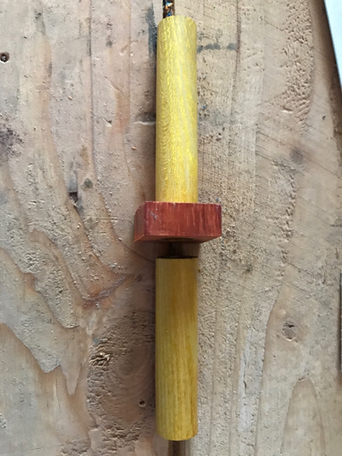

I just received an order from Berea Hardwoods with 5 of the Streamline American Rollerball kits.

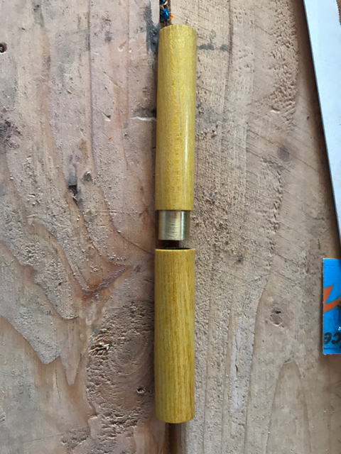

I can definitely recommend to anyone purchasing a new pen kit to research the instructions thoroughly. This pen looks great in the pictures, but for some reason I just don't understand the instructions. It gives two options on how to execute the cap section (or what I can only assume would be the cap section) , but the instructions are not clear at all. It mentions trimming the blank from 1 7/8" to the end down to the brass tube for the center band. I attempted to do this, but the only side that was long enough to get 1 7/8" was the main tube.
I finished both tubes and went to press the pen together and now I know for sure I messed something up. It looks completely messed up. I got as far as pressing the center band onto the part of the tube where the tenon was created (as instructed) and it definitely is wrong.
HELP!
Pictures can be added for further understanding.

Thanks for all the replies. You would think that since I have to read a tape measure every day at work and even come home to do it more that I would be able to read 1 7/8 as opposed to 2 7/8. *♂️. I think I was just tired and still jet lagged from my recent vacation that I just wasn't thinking clearly. I cut the tenon on the wrong one. I will try this kit again soon when I have time and energy to focus properly on it. Thankfully I have two more blanks glued up and ready to go.

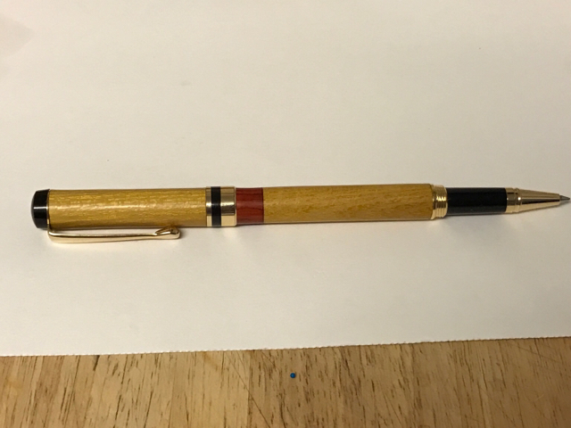

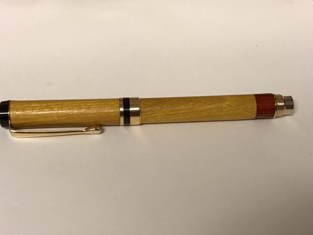

I was able to salvage my bone headed mistake. I took a small piece of paduk and drilled it out and glued it on the end that I mistakenly made the tenon.
Here are some pictures of the finished product. I used the pens plus finish on this. It's Osage Orange with Paduk accent.
