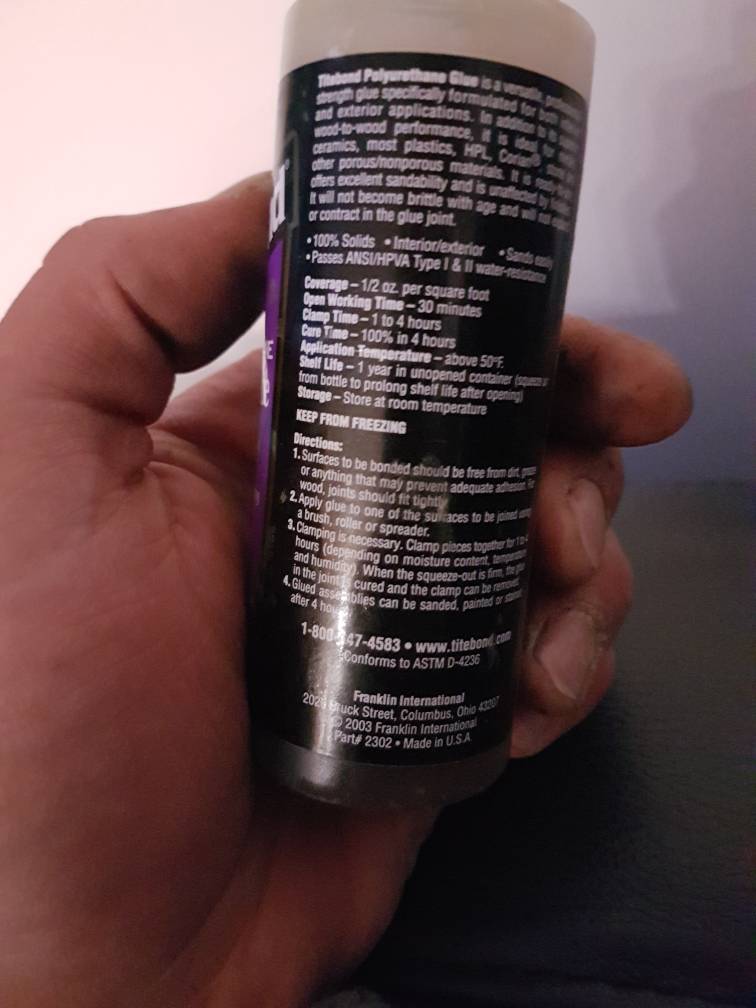

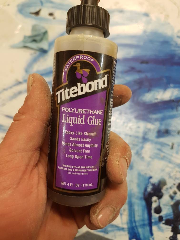

Hi
I was using CA glue to glue my tube inside my blank and wanted something better after getting some fail while turning.
Went on my favorite pen supplyer online. Found the Titebond liquid glue wich is a polyurethane glue rated 5 stars and everybody was saying it was the best. So I went for it.
Glued 5 tube with it friday night waited 24h. Came back and the excess glue was hard and dry so I tried to trim 2 blank and the tube slipped right out on the other side. I tought I did not wait long enough even if it said 4hours on the bottle.
Came back sunday tried again on another. Went well but unglued while turning so I glued it back with CA. Finally coming back monday, so like 72hours later. The 2 left slided out while trimming...
What am I doing wrong? There must be something or it's the worst produt I tried...

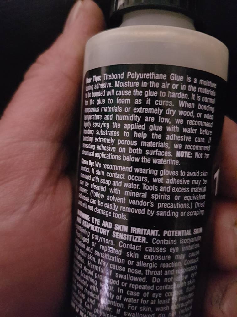

Do you wet the blank first? I dip them in water right before inserting the tube.
There ya go, that may be the answer. Those glues are moisture cure so the inside of the joint may be starved for moisture.
One sure way to tell is to see if the glue dries after the tube pushed out.

I use a small spray bottle to shoot a quick shot of water in the blank before using the polyurethane glue. Be sure to have the tube ready to insert as soon as the water hits the wood. The wood will swell quickly and make the tube hard to insert.

Wow I would have love to know this before!
I didn't know at all and it's not common sense since most of the glue ask to be dry.
I'll definitively try it.
And more I think more it make sense. The glue probably dry at both end and and seal the gap so the humidity can't get any further.
They should write it on the bottle that would have saved me some curseds words.

I'm surprised it doesn't. I use gorilla glue brand and it recommends wetting anytime the two parts don't contain moisture.
Yes, if you have a porous wood and a tight joint it can swell it enough to make a too tight fit.

Wow I feel so dumb... I only have read the direction steps and skipped the safety warning on the other side of the bottle thinking it was the usual... don't put it in your eyes,wear protection,etc.They talked about moisture in direction steps but in a way that made me feel like it was bad to have moisture.
What I did not see was the small paragraph over the warning called "user tips".
Sorry everybody. Lesson learned I'll read everything next time.
