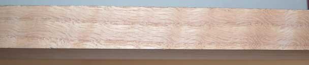

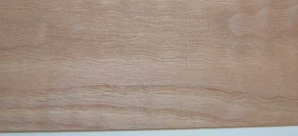

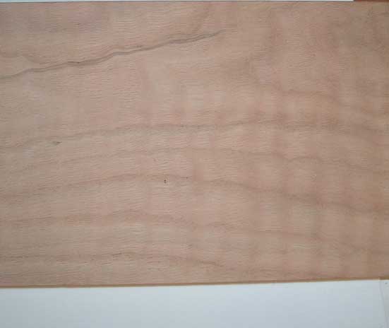

Is this curly red oak?
It seems to have the curly pattern but there is not a lot of the large waves going across the whole board. It is 3/4" thick and about 5" wide.
I was going to cut this for a piece of shelving but after looking at the edge, I'm wondering if it would make a nice blank.

Dale,
I would say 99% yes. Judging by the rays and grain, it's red oak. If you had a very close shot of the end grain, it would help.....but judging from the pic it definitely comes from the red oak family.

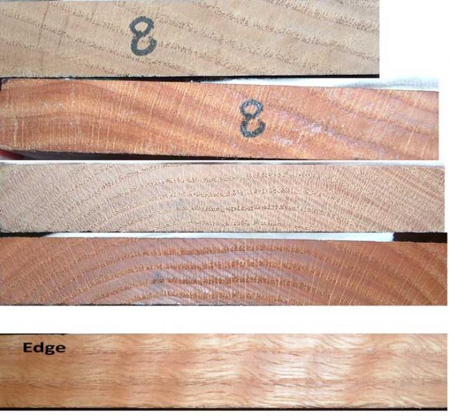

Steve. I took some pics of the end grain dry and some after wetting it with some mineral spirits. Also a side grain wetted.
It has the telltale signs in the pore structure similar to curly red oak from the pictures I could find on the web.
Thanks for the suggestion.

Yes, red oak....very defined open pores.

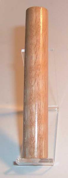

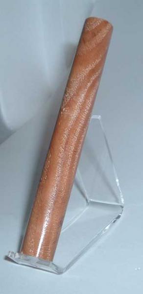

I decided to cut a slice off at a 45 degree angle and turn it round.
Sanded it down, wiped it with mineral spirits and gave it a single coat of medium CA.
It's not what I expected it to look like. It's kinda boring!:cool:

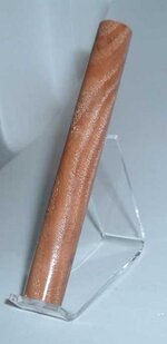

Another with a slice cut along the grain.
I can see some figuring but it is nothing to write home about.:cool:

Teat the wood with sanding sealer to seal the pores and apply your favorite color dye. Finish with CA.
Do what to the wood? Funny typo!!!!!
You can also use an acrylic paint like a grain filler in that open grain. Sand it back off and you get a real nice splash of color. Some will use a color wax after finishing, but I like to use colors like bright red and blue to fill the grain.
