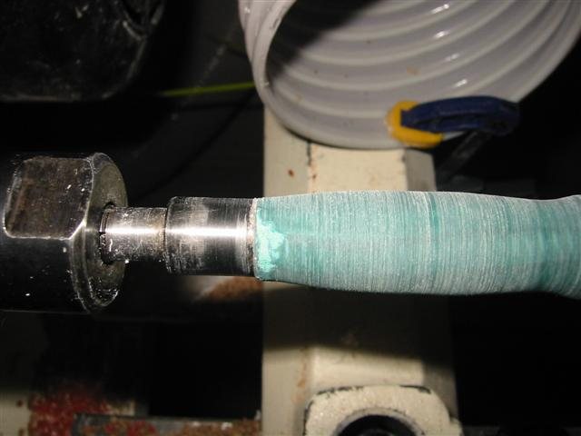

I started working on this lizard skin blank tonight- if the shape looks familiar from what can be seen, yes Billy, I blatantly am copying your sierra shape (printed it out and everything for reference). Anyway, when I was just about done turning- I notice what looks like it's going to be a crack or something that's going to look wrong when I get done sanding. Anyone know of any way to fix this? I stopped sanding where I was, because I didn't want to get it down even further to where maybe nothing can be done.
There's also a very small similar area that seems to have developed at the other end of the blank- nothing like this showed up the whole time I was turning. Kind of hard to come up with an oops band that'll work on this- plus I'm getting kind of tired of making those- it seems like about half of the pens I've made recently have one on them- maybe I need to start calling that my style of pens?

Angela, use thin CA to seal the crack, then thick to bring everything to the same height, level, etc. Let it dry for about 30 minutes and VERY carefully and gently skew it off. You should then be good to go.

On a side note, your camera is either playing tricks on us or you have a bushing that is very out of round.
Oh, and before you use Billy's idea, <b>clean</b> with DNA or compressed air. Any grit from turning will be incased in the CA if you dont!

If it's what I think it is, that is called "shatter". It usually happens when trying to take off too much material at once or it can happen from a catch. The resin "shatters" like an automobile windshield, but does not blow out. Thin CA MAY help the appearance...but like Skye said, after cleaning it off with compressed air.

Whats your thoughts on her bushing? It's flush at top, but not at the bottom. Dont know if that's a result of the catch or if her bushings are out of round.

Yeah, I've been looking at people's bushings when they show pics. I've got one out of round, so I'm a little hypersensitive to it...

Anyway, I tried to work on this blank tonight and just couldn't seem to get it fixed- you could still see where the cracking was, and the CA glue seemed to leak under the clear whatever-the-stuff is that's over the skin. So, I'm going to try to just turn off the end and figure out something to put on.

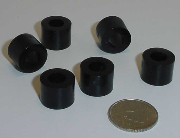

I think that a nice simple black acrylic oops band on either end of the blank will do the trick. Especially with the Sierra kit. I will blen nicely.

On a serious note, if you wish to try Fangar's black acrylic oops band idea, I can gladly mail you a handful of CB's that may help. They are 1/2" od and 7mm id. Keep trying to revive your lizard and good luck.
