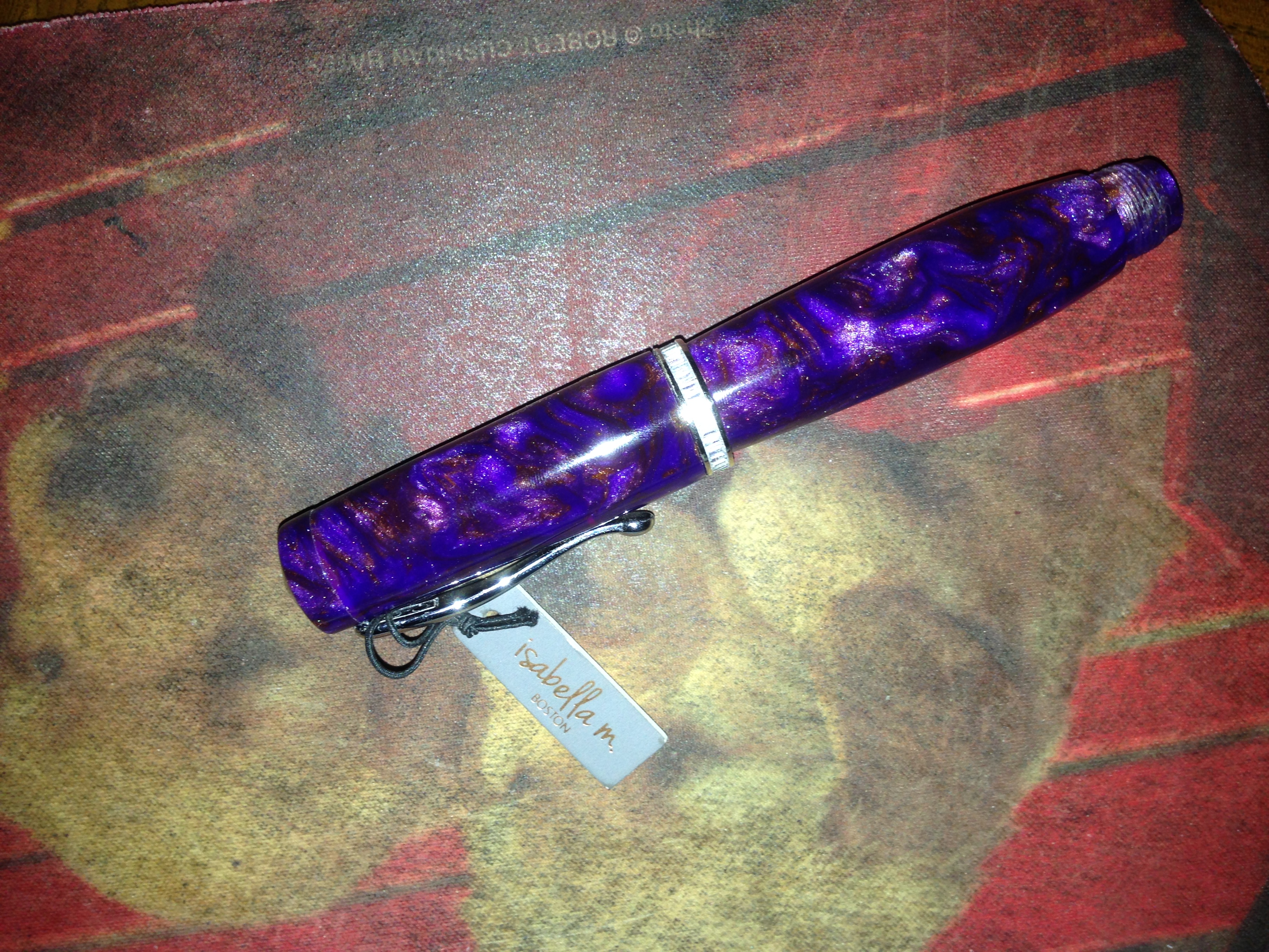

Today I made a New pen
I used a El grande Section (M10 x 1)
Drilled the Body inside 5/16
The threads are 14mm triple
The Cap is 14m triple To match the body and the clip is a triton and the end cap is 6mm x .75
