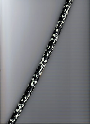

Will this work? It is dalmation decora...no longer available. I can part with one if it will work for you. The rod is round, .667" in diameter and 12 inches in length.

I got the blank in the other day and finished off the kit today. Just an Americana (CSUSA kit) for a thank you gift. I am glad the blanks were extra long and not "grain specific" because the first blank blew up while drilling on the lathe! Had to keep it very wet and slow drilling was the key. I kinda like the material in an odd sort of way. [:D]
Here is a quick photo. All the black on this kit really fits well.

Lee! Nice pen! So, was that Decora? It is a bit different to work - feels a lot like the consistency of Corian, maybe even softer, as far as working qualities, but it's not so soft as to scratch up easily after you're done finishing it! Nice!

Yes it was the Decora. It worked pretty well, kinda "grabby" on the skew and it gave off thin slivers for shavings You had to kind of "catch a groove" and ride it with the skew or you would loose your cut. You can notice the softer material as it was very hard to get out every scratch and I had a very light round over on the center band edge. I could tell, but no one else would ever notice it.
The real challange was the drilling. I held it in my pin jaws ont he lathe and without water I blew up one half, lucky for me, the left over piece was big enough to replace it. I had to drill about 1/8" at a time and wet the blank & bit. The bit would be hot enough by then to steam the water a hair. This was on my lowest setting (600 or 700)
