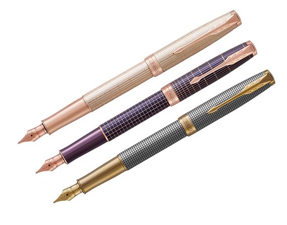

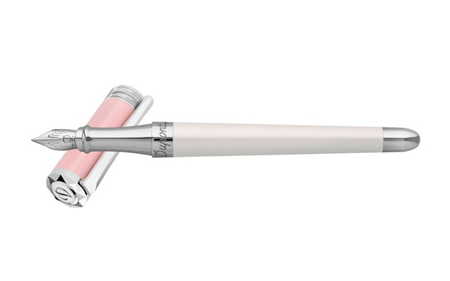

My friend has a customer that wants to buy a really high-end fountain pen from him. I'm trying to help him find the right kit but I can't seem to find the style and quality that the customer wants. It is for his wife so he does not want something too masculine. He gave a few links to pen styles that he would be interested in. I'm not sure how particular this customer is but know that he is willing to spend as much as it will cost him for a VERY nice pen. Anybody know of any kits that would be at all similar to the pens below?
I understand that these are not handmade pens but the customer wants something similar. These are the photos he gave of pen styles that he is interested in:
Any help is greatly appreciated. Thanks!

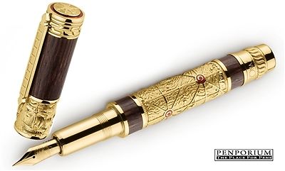

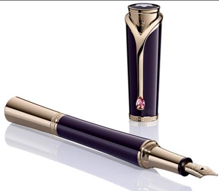

These are the pictures that the customer came up with on his own. I know that there are no kits out there that are the exact same as these but hope to find something similar if possible.
I would hesitate to use pictures of pen than you cannot replicate.
These are all wonderful pens, but as an example... The first pictures have both horizontal and vertical "cuts" but if you cannot do this, do not include them in your portfolio of "Possible."
Highlight what you have already been able to do, and what you have reasonably mastered!.
