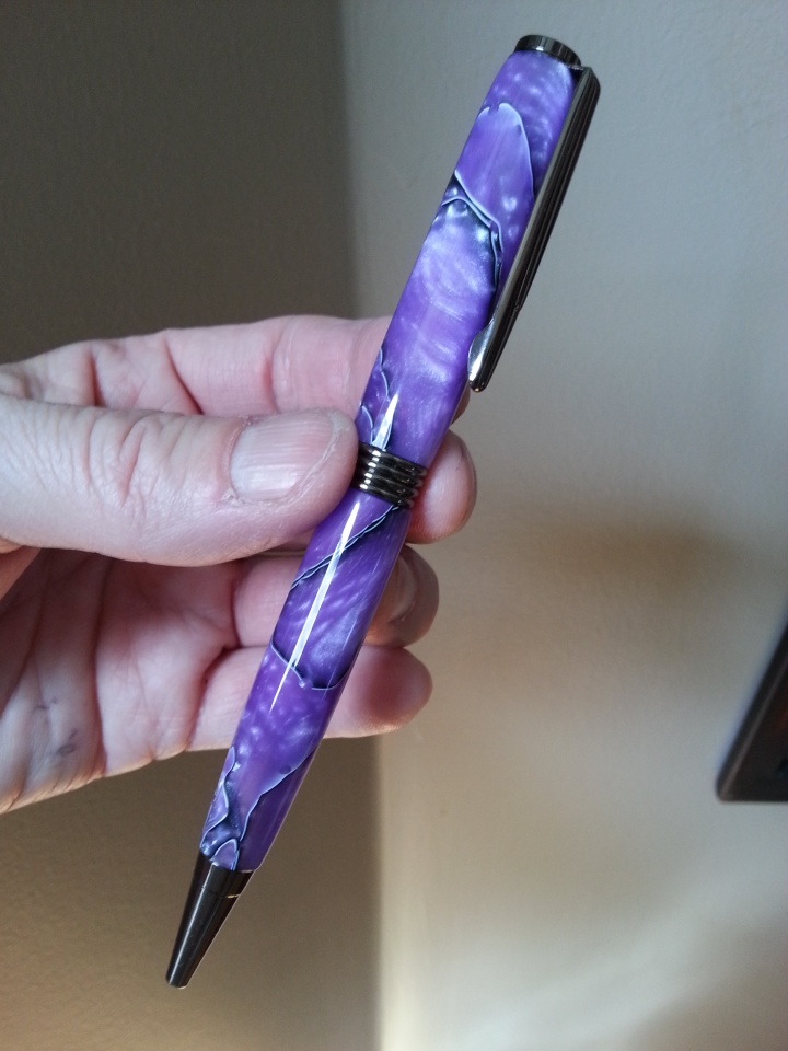

This is the one many of you (especially) Old Man helped me salvage
Made this for my mom. Pen number 9 for me. I will never make it as a hand model (or photographer). Separately, I have noticed that two of the two WC trim line kits that I bought (they were the inexpensive $5 kits) were a real struggle to get the center piece over the twist mechanism. That's what started my initial problems. It could easily just be me :).

Thanks folks! I still need ot work on my finishing. I am near-scratch free, but not 100% scratch-free. I also used DNA and learned that it smears some of the "artwork" on the acrylic. Live and learn! Have good night guys :)
