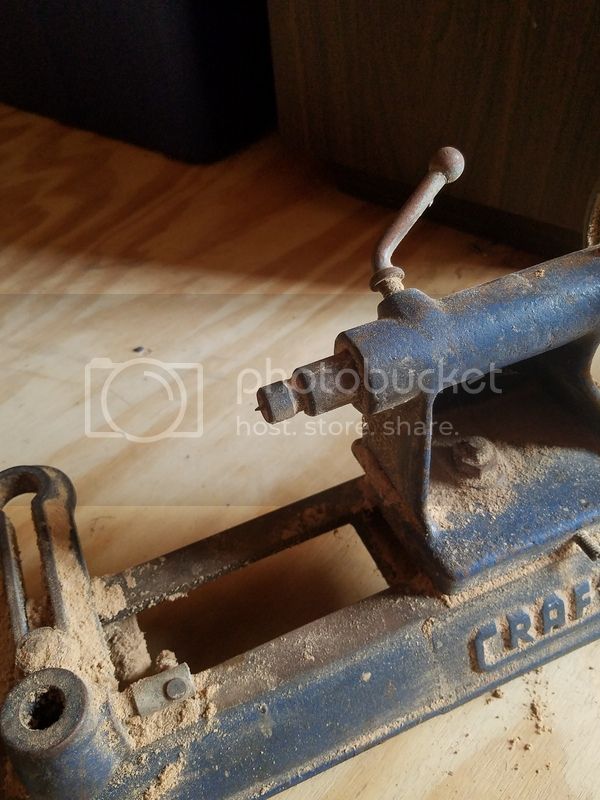

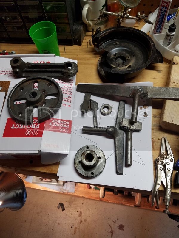

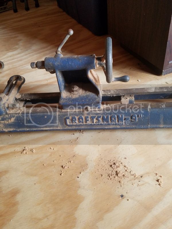

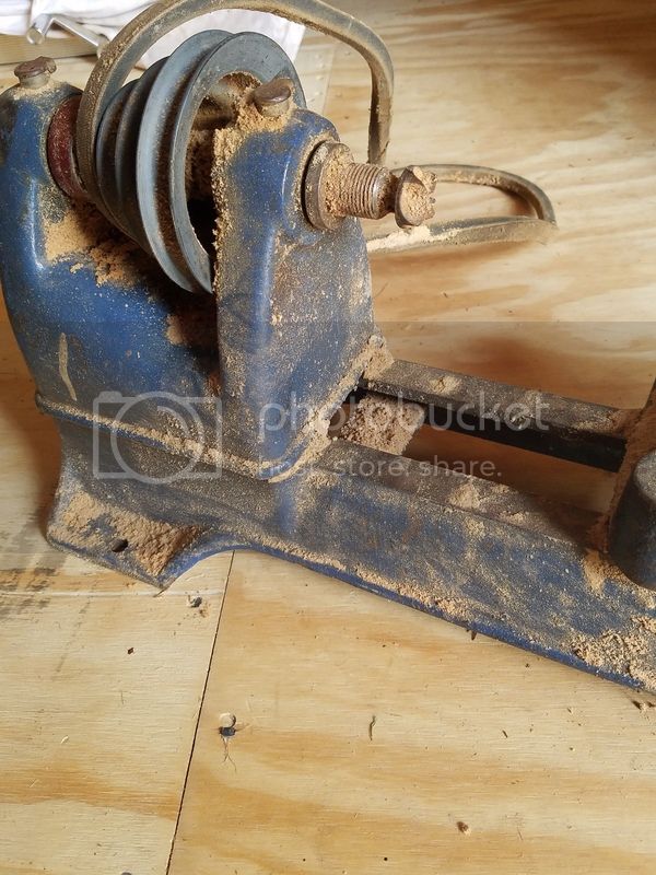

One of the tools that I picked up was an old Craftsman lathe. I do not remember ever seeing my dad use it growing up. He said that he and hisdad bought it together used. I am trying to find out if it can be used to turn pens. I am slowly fixing a one car garage into my shop. Because of this, the lathe and motor are in a shed out behind the house. I took a few pictures of everything and figured some of you may be able to tell me what's what. I am completely clueless.

With some cleaning, lubing, and determining your taper it should do well for pens. Welcome from Colorado.

Welcome to IAP, Jeff !!!!! . Looks like you should be able to use that stuff, but it will take a little getting used to it.

How do I determine taper?
The taper refers to the inside angle for your tail and head stock. If you take out the drive center from the headstock you should be able to match it up with the correct mandrel for turning pens on your lathe. Taper is designated as Morse #1, #2, or #3.

Looking at the lathe and following Mike's link from above and delving into it a ways. It looks like this was a Craftsman Companion 9" lathe produce from 1935-1936. I found some pictures of it from a company over in the U.K. if you follow the link below, you'll see it about 2/3rds way down the page, under the header of Craftsman, Companion and Dunlap, Wood-turning lathes 1933-1943.
Craftsman, Companion, Dunlap Wood Lathes 1920s to 1960s
It appears that it takes a #1 Morse Taper. I'm still pretty new to all of this myself, but I do enjoy looking at the old lathes, so take it with a grain of salt that this is 100 percent the lathe that you have, but from what I can tell from your pictures and theirs, they appear to be the same.
