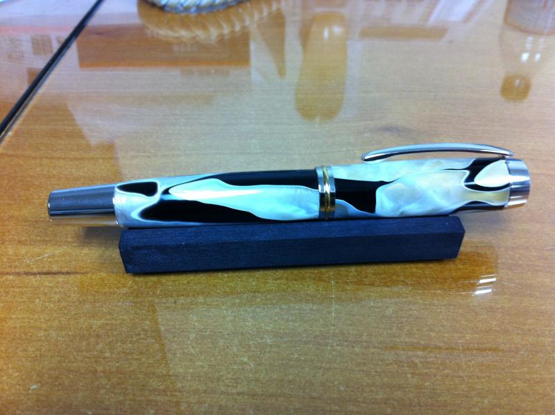

I've posted some recent projects here and I'd love some feed back, possibly a few critiques on what I can improve on! Please feel free to ask me any questions!

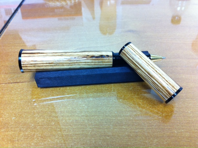

welcome , nice pens . the first one has a blue tone to the picture ( could just be the stand its on ). I like the second one in the wood with the imperfection in it , gives it charator . both looks to have good fit and finnish.

Hi Sam those are some nice looking pens, you fit appears to be well turned and you finish is nice, what did you use for a finish on the Panache??

Hi Sam - Welcome! Nice looking pens. Could just be me but I think I see the brass tube showing through on the acrylic pen. I always paint both the inside of the blanks after drilling as well as the tube itself. Different colors give different effects.
The Panache pen looks great too! I like the kit/wood combination.

Welcome, nice pens,fit looks good and the blue cast could be you need to adjust your white balance. Be sure to ask any questions you think of we don't bite! And hopefully we can do the same of you if we have questions of CSUSA....

I used a CA Finish on the Panache.
You can definitely see the brass through blank on the Gent... Not my favorite one I've done. I'll have to try painting them next time. Any tips on what to paint them with?
As for the coloring on the pictures, I took them with my phone... No real way to adjust the white balance though :frown:

I did the exact same thing, with the exact same blank on an artist's sketch pencil. http://www.penturners.org/forum/showthread.php?t=74010 A lot of people will use modeling paint (Testors) to paint either the tube, the inside of the blank or both. Welcome to the IAP!

I just use cheap spray paint from Dollar General. It coats well, and dries really fast. I usually do 2-3 coats per blank just to make sure everything is covered, then let dry overnight before gluing the tubes in. I mainly use white and black paint. White will keep the blank true to its original color while black will darken it and sometimes give a really dramatic effect.

I paint the tubes and the inside of the blanks w/ whatever cheap spray paint is handy in the right color.......Now about my super special discount.....

Pens look very nice! Given that the pics came from a cell phone you get a "pass". :biggrin:
Along with painting the inside of the blank and tube, I will sometimes mix a drop of the paint with the 5 min epoxy when gluing the tubes in.

Nice line up on the pen and painting will definitely help you out - some just use the chameleon tubes but understand that will still leave you open to seeing the "glue bubbles" through the blank.
