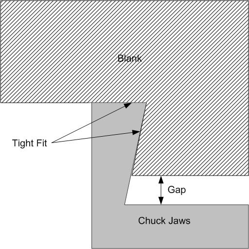

A point that I eventually learned the hard way is that the exact fit between the chuck jaws and the dovetail tenon is critical. Here's a sketch that illustrates what I mean.
It is important that the taper of the tenon (spigot) match the taper of the jaws, and that the exterior face of the jaw fit tight against the blank. But it is also very important that the tenon NOT bottom out in the jaws - there must be a gap between the bottom of the tenon and the interior face of the jaws.
the strength of the grip comes from having a tight fit in the corner between the side of the tenon and the back face of the blank.
