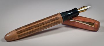

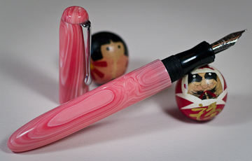

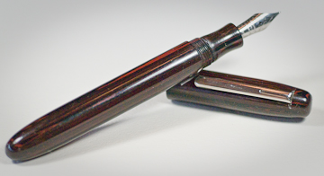

...first, because I couldn't get on the site for some reason (it magically came back about three weeks later), also because I've been fighting a cold my grandchildren gave me for Christmas (the gift that keeps on giving). These are three I finished today -- Asian pink coral (Truestone), red and black ebonite, and Pink Ivory inlaid with Leopardwood.

I'd like to know a lot more about how you did the pink ivory/leapoardwood blank. That's REALLY beautiful. Of course all the pens are very impressive works of art, in my opinion. Kitless pens always impress the hell out of me.

I'd like to know a lot more about how you did the pink ivory/leopardwood blank.
The pockets are cut with a CNC mill, then I cut over sized strips to inset. The strips are set in with epoxy then the whole thing turned. The trick is doing it so you don't weaken the wall of the barrel (which is only about 1mm thick). Typically, my pockets are about 0.5 mm.
