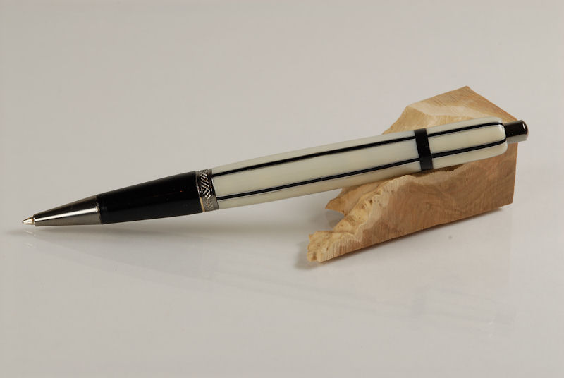

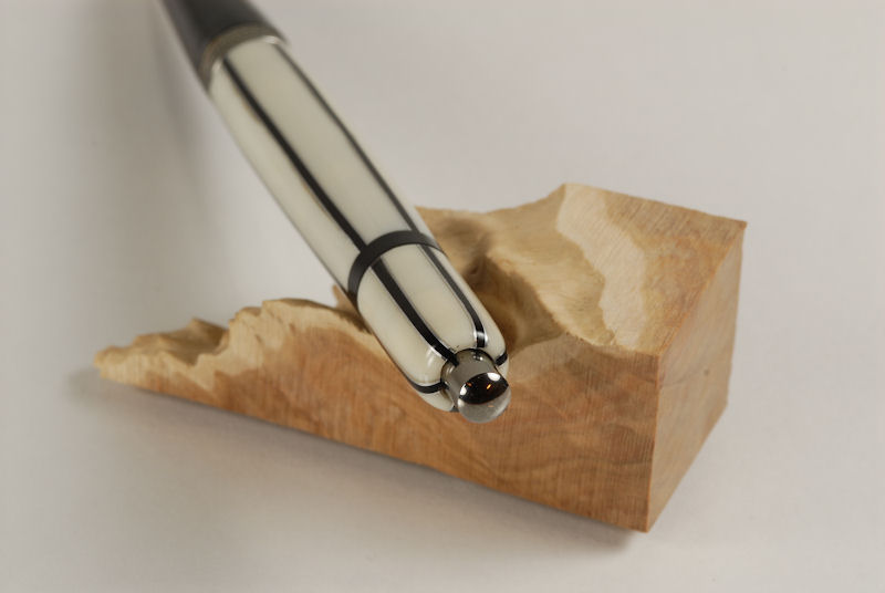

Has this ever happened to you?
rherrell
Aug 22, 2006
6,337
Pilot Mountain, NC

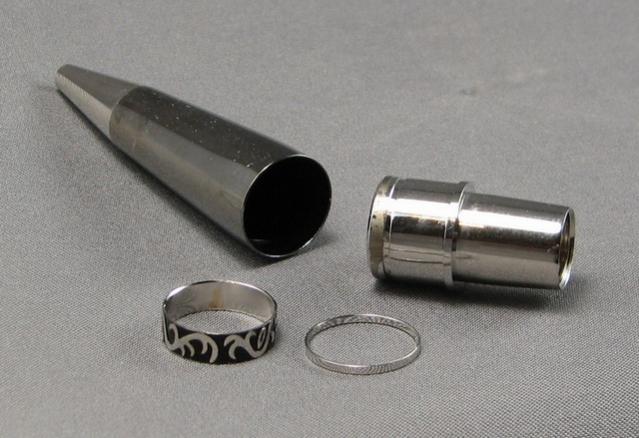

Rick, what you have now is a perfect opportunity for a modified Sierra :biggrin:
I took that piece apart when I made this pen:
When I took it apart it needed a lot of persuasion!!! I wish it had come apart easier.
The piece that I turned to replace the black metal lower barrel almost made it off the lathe as well. It was so close to being finished before it blew up :frown:
Maybe you can come up with some other modification :wink:
