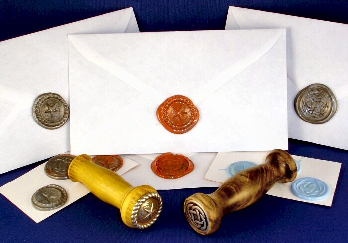

Here's a couple I made from buttons a while back:
