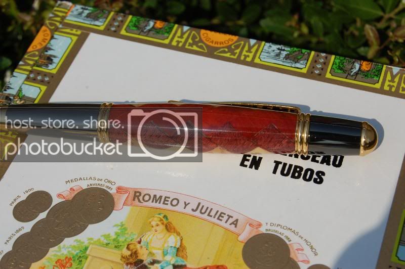

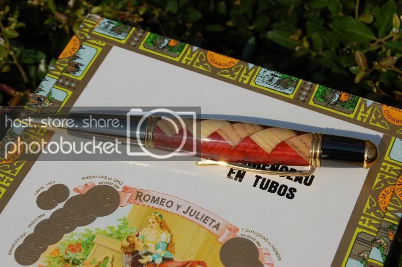

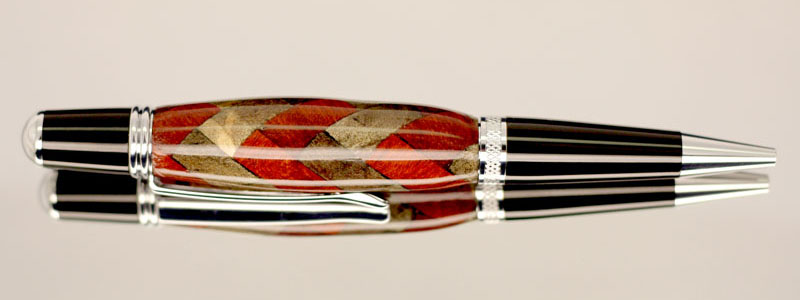

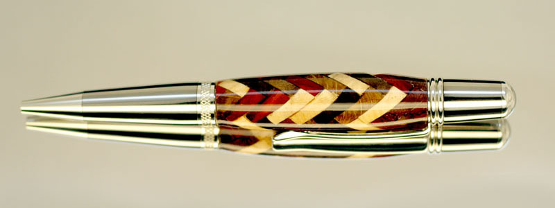

fear not Darrins instructions do work, I eneded up printing them and putting on my workbench and looked every few minutes. try and make sure your pieces are really close to the same size (square) before you start cutting. I used a board for a guide on my bandsaw to get all pieces somewhat the same thickness. I also cut alot of extra pieces of each one so I could make spares of the sets of 3 and needed them. Make sure you are cleaning glue from cracks as you go( you will be glad you took the extra time) It took me about 4 days to get mine from concept to tube and I wish I had tuned it between centers to true it before drilling(little off center) It took me a couple of tries to get it right.
Here are the results.
LarryDNJR
Feb 28, 2010
912
Columbus, OH

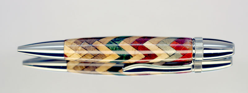

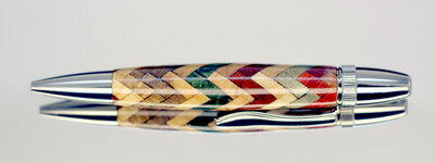

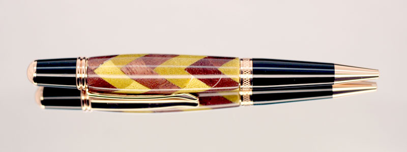

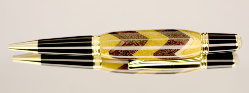

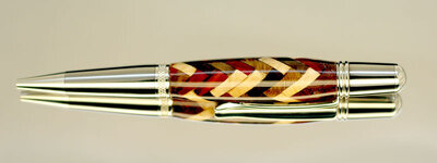

Some examples of my 360 HB
These are the 5 360 Herringbone I came up with following the tutorial

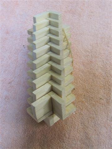

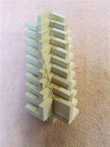

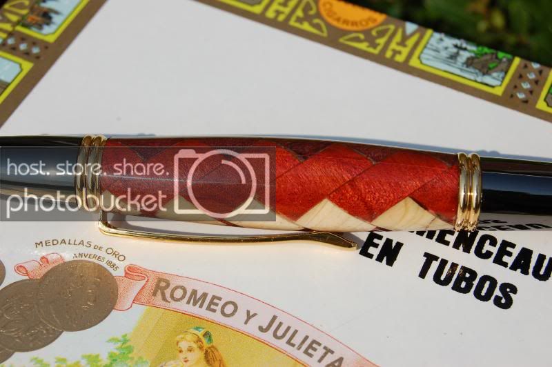

I haven't bothered to view rojas Utube vid, since making one pen following Darrin's instructions, I feel I could put one together in my sleep!

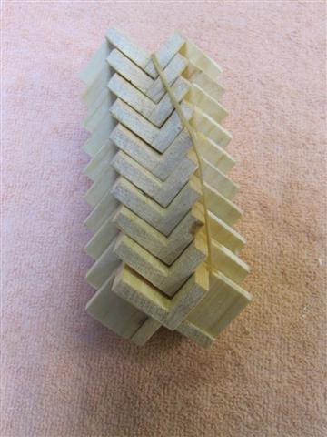

Here's 3 picks of the pieces put into position prior to glueing up which may assist you. I used LePages Carpenter's glue to glue the pieces together. Not as messy as using CA in my opinion at least.
attachment.php
attachment.php
attachment.php
attachment.php
I trust these pics will assist as well as viewing the Utube vid. It was not my intention to hijack this thread only to provide any assistance that I felt I could!:biggrin:
