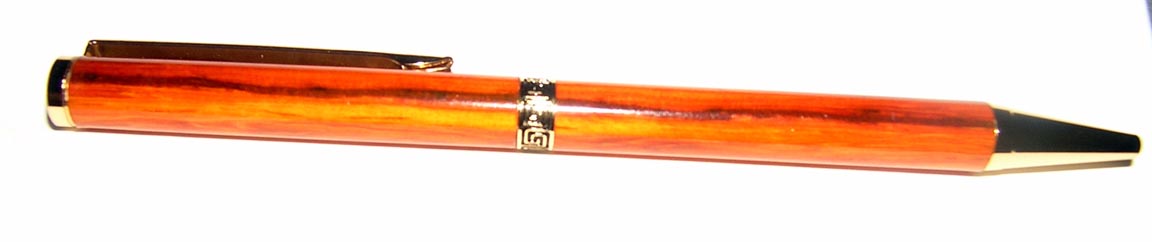

My first pen almost 5 years ago is here: http://www.penturners.org/photos/images/940/1_1st_pen_photo.jpg
On the nib end (technically by some it is not a "nib" on ball/rollerball pens) there is a high spot on one side and is visible, the other side is flat against the nib. How you describe it technically would be appreciated. But in the end, we still have this common problem that occurs on mandrels for one reason or another.
Some of these high/low spots are caused by Off Center drilled bushings. Some are caused by wobble/vibration on the tail stock end when using a Live Center made for wood lathe - that is placed into the dimple of a mandrel. The dimple hole of the mandrel and woodstock live center do not fit correctly, causing wobble, vibration or what ever that is not normal. Too much tool pressure against the spinning mandrel also causes this problem at times.
