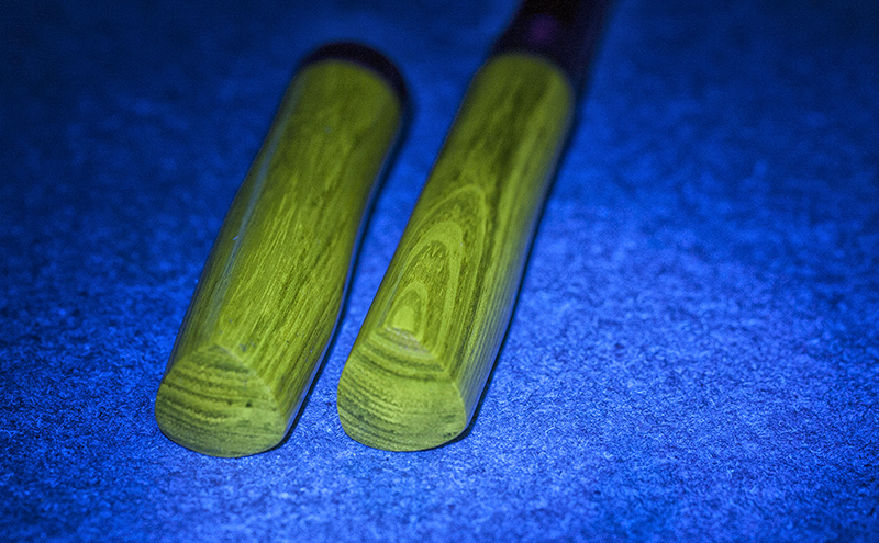

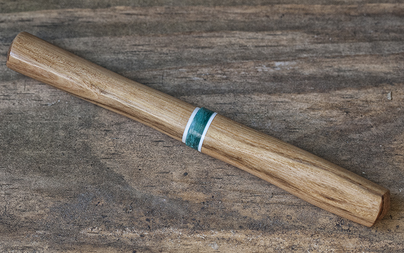

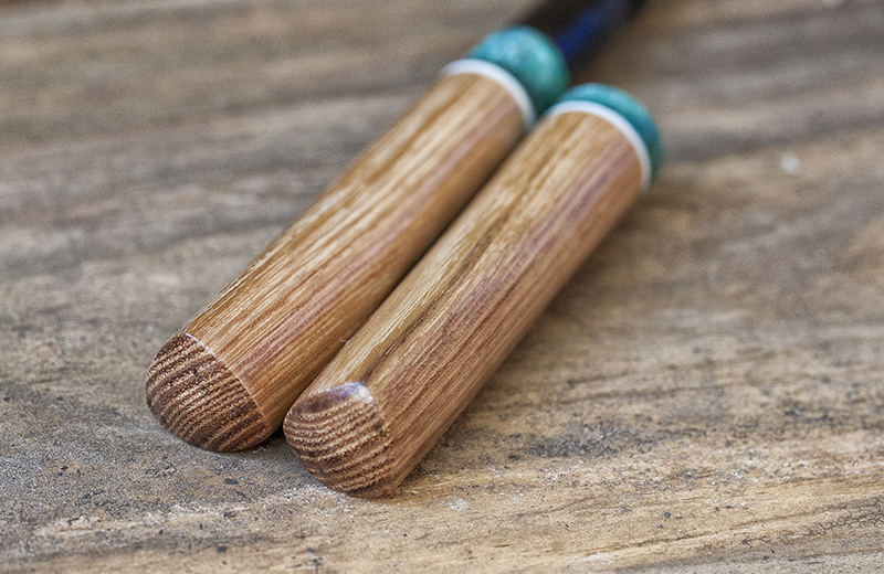

Seems I have had a small out-of-round problem lately, it's kinda subtle, can you spot it?

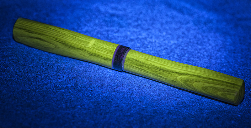

On top of that, it glows under UV light!!!

Very nice, very cool! Didn't know locust would fluoresce under UV...that is very interesting...

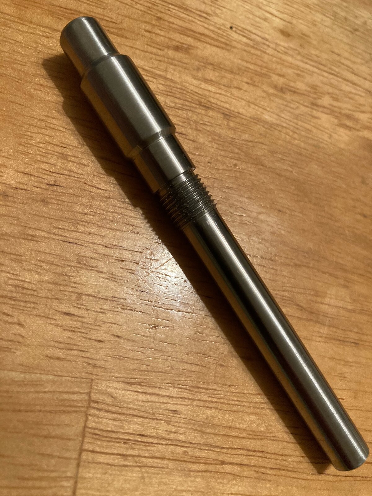

Any chance you could show the nib of the pen?

The section in these pictures was scavenged from another pen, a dedicated section made the same blank as the center band is in the making, I'll post a picture once it's finished.

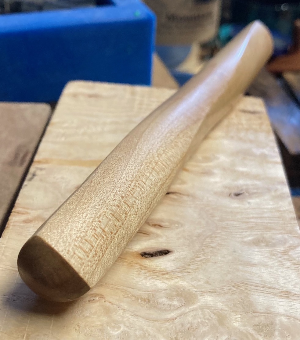

Thanks Todd! The picture shows what I was aiming for (this was a test piece, not a pen), a twist running along the length with the "crest" on one end would match with a flat on the other end. In the pen the junction between the cap and body would be in the middle where the "crest" is at its lowest. And by using a triple start the body and cap would always align that way. In retrospect, using honey locust was not an ideal choice for the blank, the straight grain and uneven texture made the cuts too coarse. I'll probably use maple for the next try.
