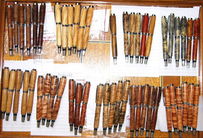

For those that remember, I am the one who got an order for 100 chrome barons with names engraved on each one. Well, thanks to Bill Baumbeck and Ken Nelson I am halfway there. Here are 52 Barons in hickory, locust, buckeye burl, pomelle bubinga, sappele, curly mango, curly maple, red mallee burl, spalted maple and maybe a couple of others. The rest will be other woods. This is my first "production" order of that size and you start learning time saving steps real quick. I started turning pens as a hobby for fun, I am retired and don't need a job and this order is quickly going in that direction. But, only 48 left.
By the way, I am using the Norseman bits which in my opinion are the best bits I ever used. However, the 15/32 large one leaves just a tad more slop in the top barrel than I would like. Does anyone else have this problem? If so, any fixes? I have not found a 29/64 bit of good quality, any suggestions.
I will show the last 48 pens, hopefully in the not to distant future.
Jim R

WOW!!!
that sure is a lot of barons and a lot of work.
those pens look great.
my trick to the baron top is to drill it with the 29/64 bit and then the 15/32 bit. for some reason this seams to keep the slop in the hole to a minimal amount. i have had no explosions doing it this way.
with drilling it with just the 15/32 bit i have had the wood explode off of the brass tube.

Keep at it. Those look great. I know how you feel. I thought I would try a show next month with some family members that do the Christmas shows every year. Upon the recomendations of the members of this forum, I decided I needed an inventory of around 100 pens in various styles. I have between 40 and 50 right now with about a month to go. I hope mine look half as good as yours.

Thanks for the update...I have been following your post/progress from the beginning.....I bet when you are done you won't be itching to turn a Baron any time soon! Great job....

I believe it is a Bevy of Barons[:p] it is certainly a passel of pens. And they look good!

What a beautiful set of pens.
I hope you'll post some close-ups of your work.
I'd sure like to see some of these grains in more detail.
