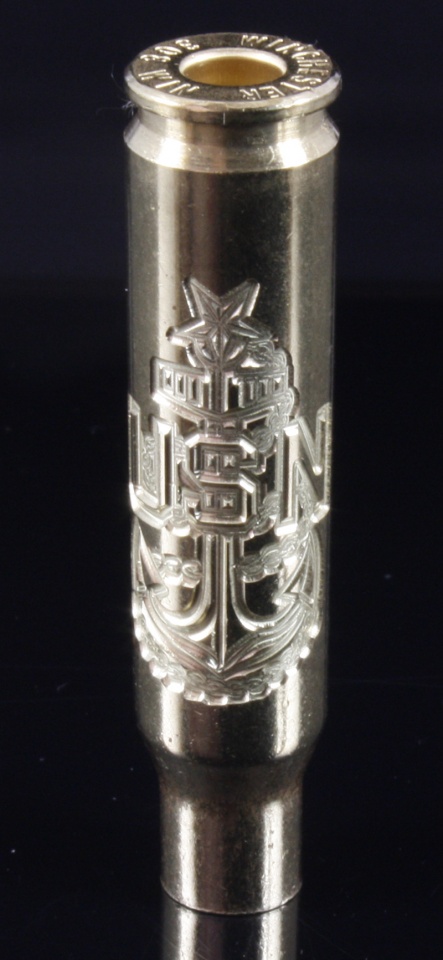

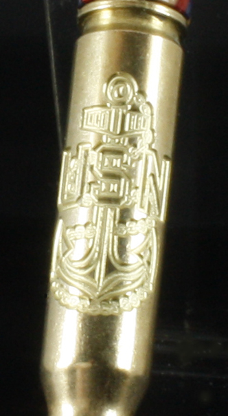

US Navy Chief emblem CNC engraved on a 308 cartridge.
I am very excited with the way this one turned out!!! This engraving will truly last a lifetime!
Comments requested.
Thanks for looking!

It was actually not laser engraved. It was engraved with a tool in my CNC. Haven't powder coated it either. I am a believer that the copper should be allowed to patina if that is what the recipient wants. They can clean it or let it turn colors....

That can be arranged Dave. I plan to make many different styles of these. I have a process down now to convert graphics and such so different designs should be possible. The hardest part was getting the alignment correctly! Did you know the cartridges are not a constant diameter?!

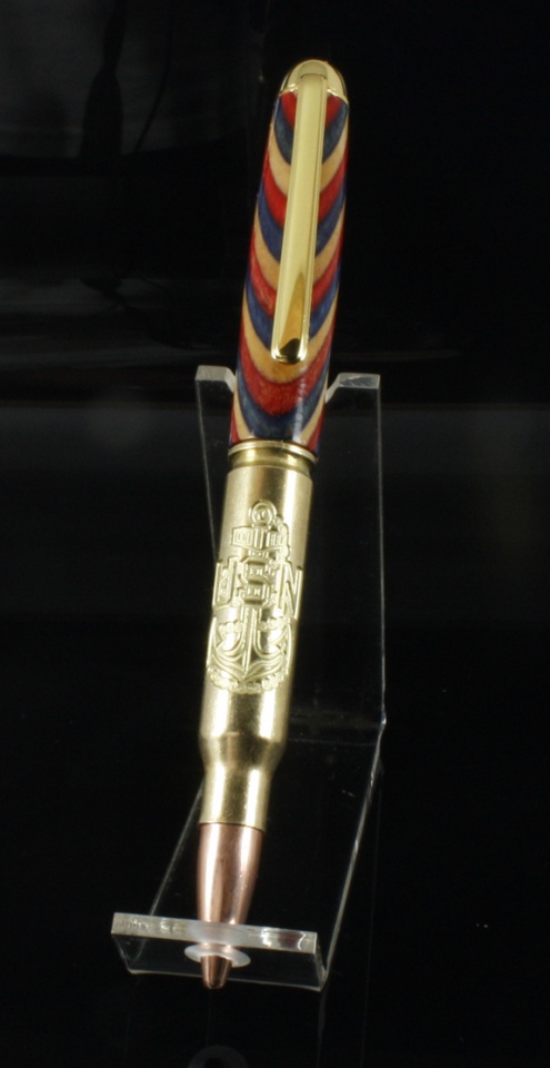

The cartridge is a Winchester 308 that was placed in my 4th axis of my CNC and the design was cut into the cartridge with my engraving tool. Multiple designs are possible. After it comes out of my CNC I buff it to remove any remaining brass particles.
The bullet is a real 30 caliber slug. It is drilled out to fit the Cross ballpoint refill and lead melted from the slug. It is then assembled.
Is that what you were looking for?

The engraving takes about 30 minutes to complete. Can't go too fast as you will break your tools. DAMHIKT! They are not cheap when you break tools either.....
I have a Taig with a 4th axis so I can do rotary work. Possibilities are endless!!
Nice! I didn't know CNC can do such a small job.:eek:
You would be surprised how small you can get some of the bits. They have some bits that have a point of 0.003" :eek:! The hardest part is you can't cut deep or fast. That is not a problem with this project though.

For this type of project it is mostly software driven. When you start working rotary, the process gets much more complex.....
Then you get into graphic conversions and vectorizing graphics....need to be a graphic designer along with a machinist all in one! Good thing my wife, Tina, does graphic design work!!

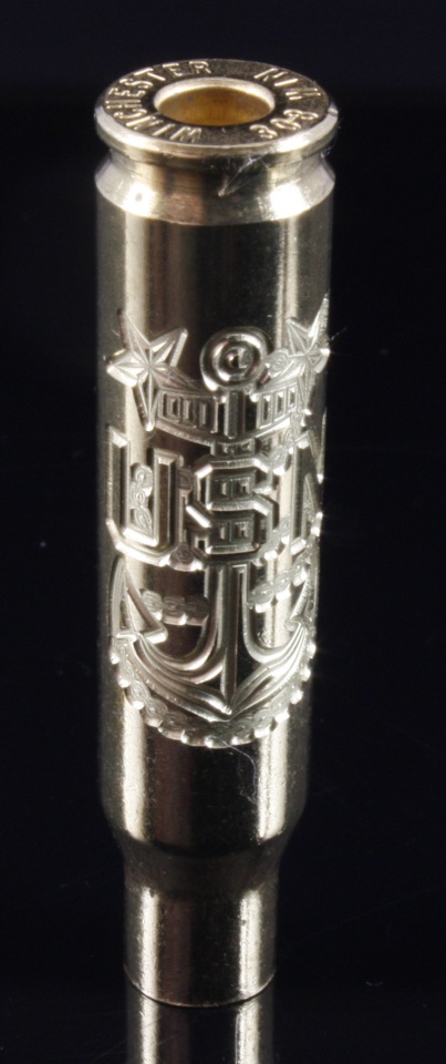

Well Paul and Dave, does this work for you? LOL!!
Been busy today with more designs but they are not pens so I won't post them here other than these couple as a tease.....

omg. Those are even cooler. The photos make them look really good. Very nicely done. I will need to add cnc to my list after laser. :)
Jan 4, 2013
403
Chesapeake, VA
There is something missing from the Anchor. Oh yeah, a star and a shield instead of letters.
Very nice work Fred. What format are the graphics files? I may have to drop of some clip art for your collection.
I can work with anything pretty much Dave, it would be much appreciated!
