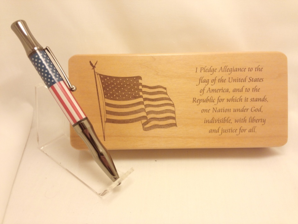

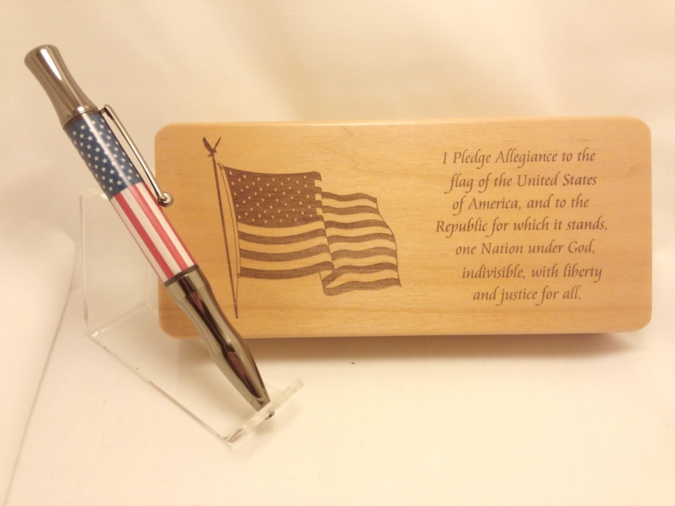

I have recently purchased the Virage Kits in Gunmetal to evaluate their suitability for my lineup of pen offerings. It looks good, but I wonder about the durability over the long haul. The Berea site does not include this plating in their listing of durability ratings. I recall a few years back that gunmetal did not have a very good rep, in general, as a long lasting plating. Can anyone provide some current durability evaluations?
