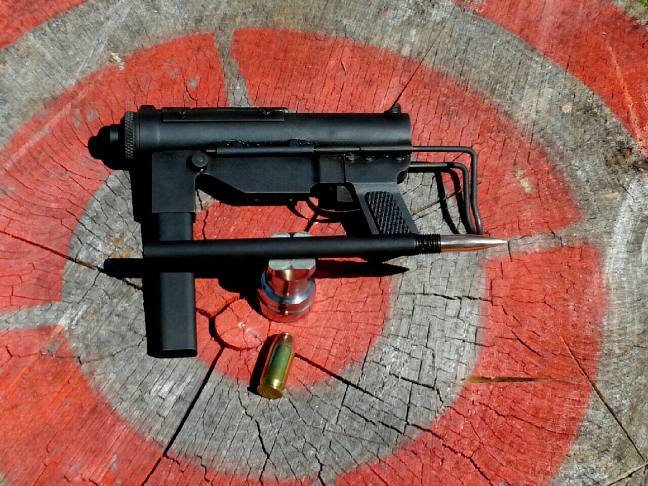

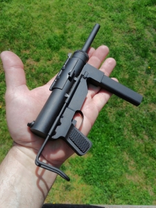

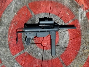

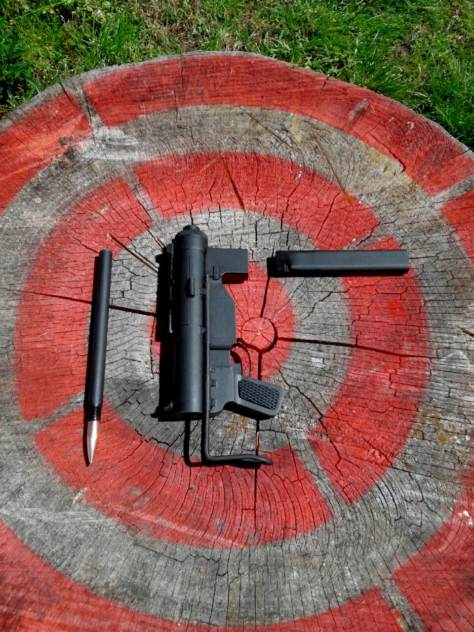

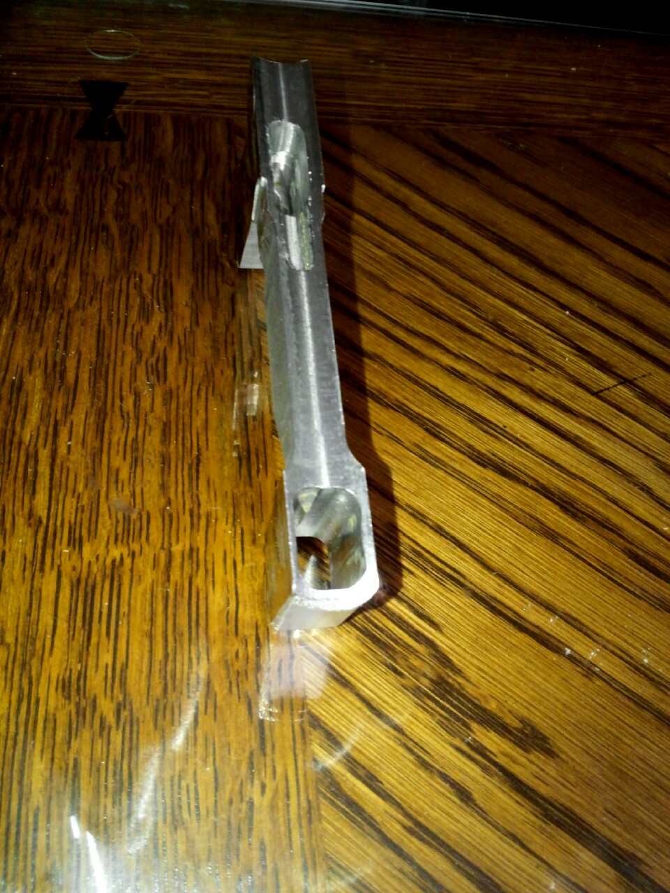

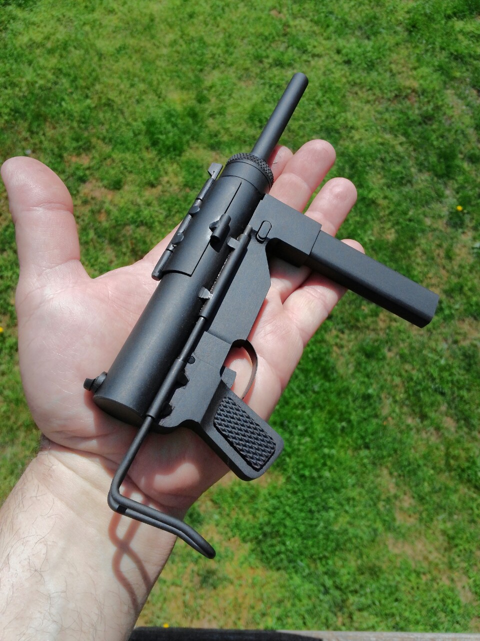

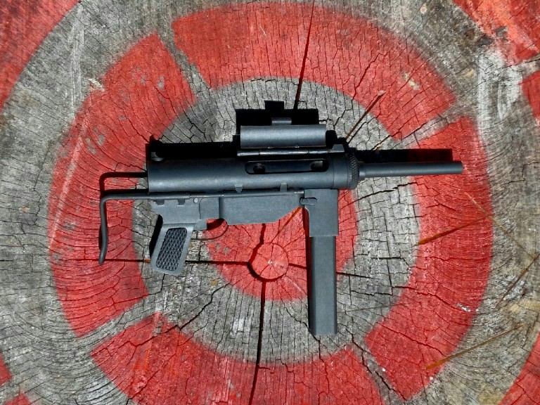

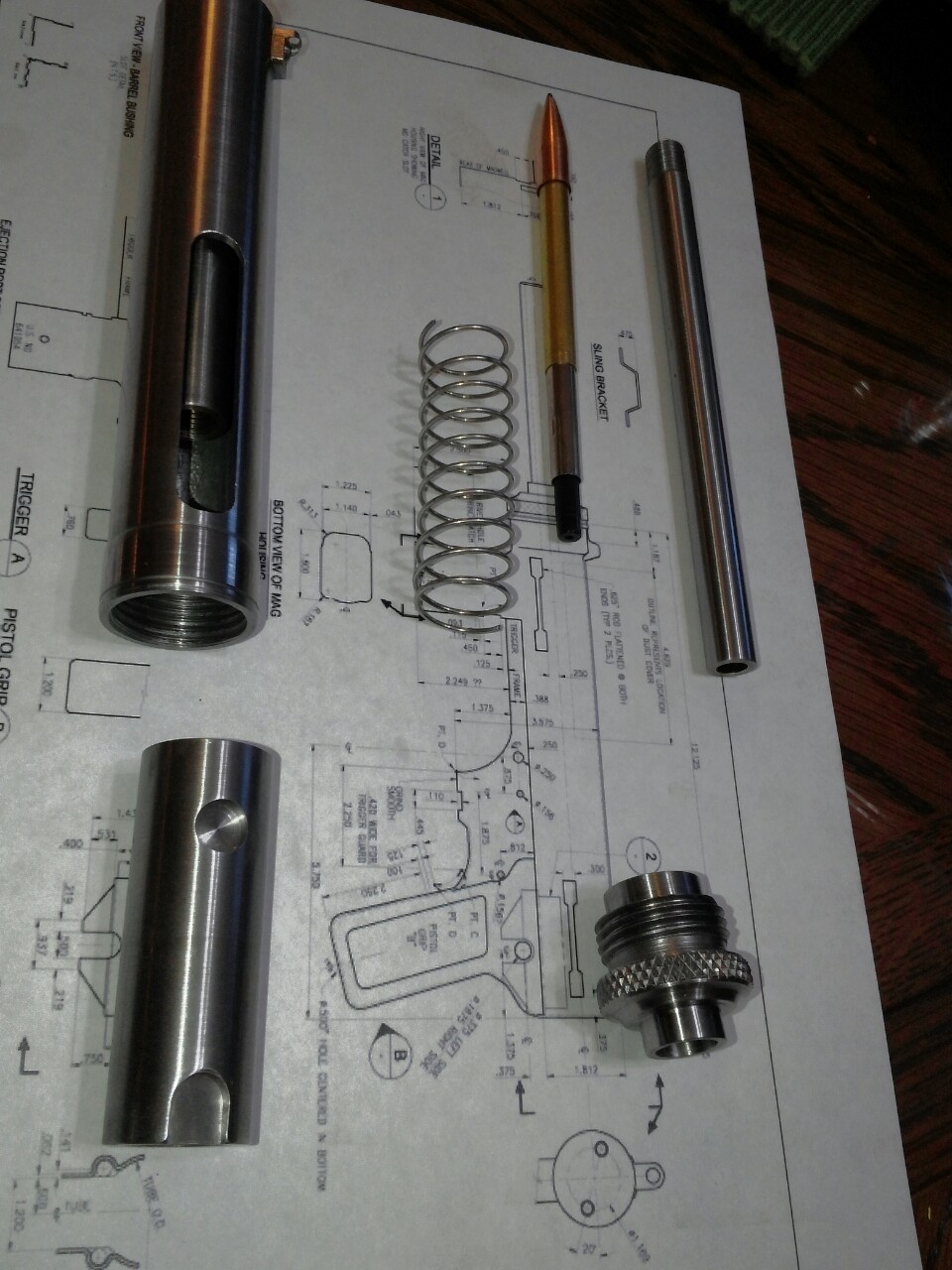

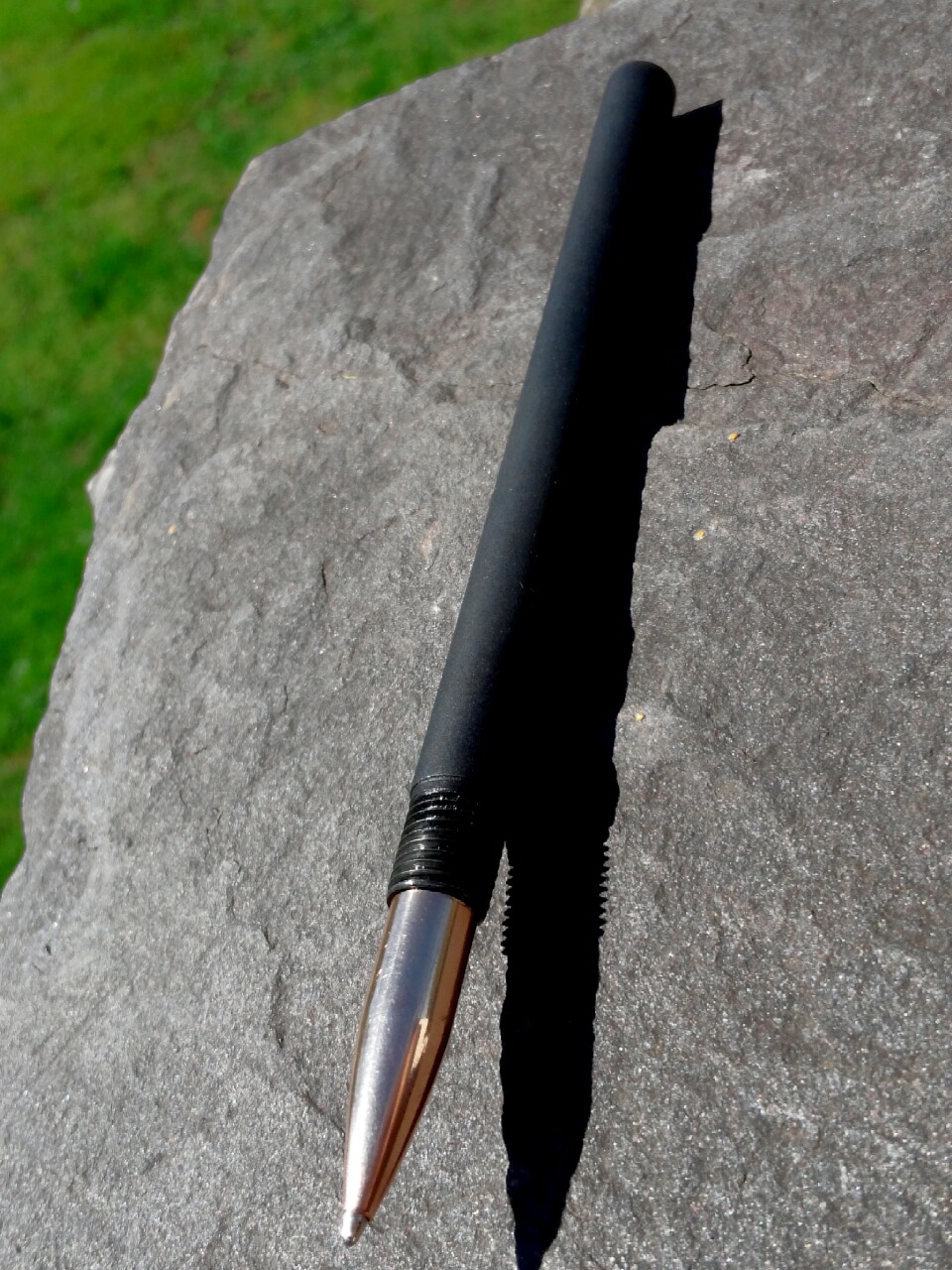

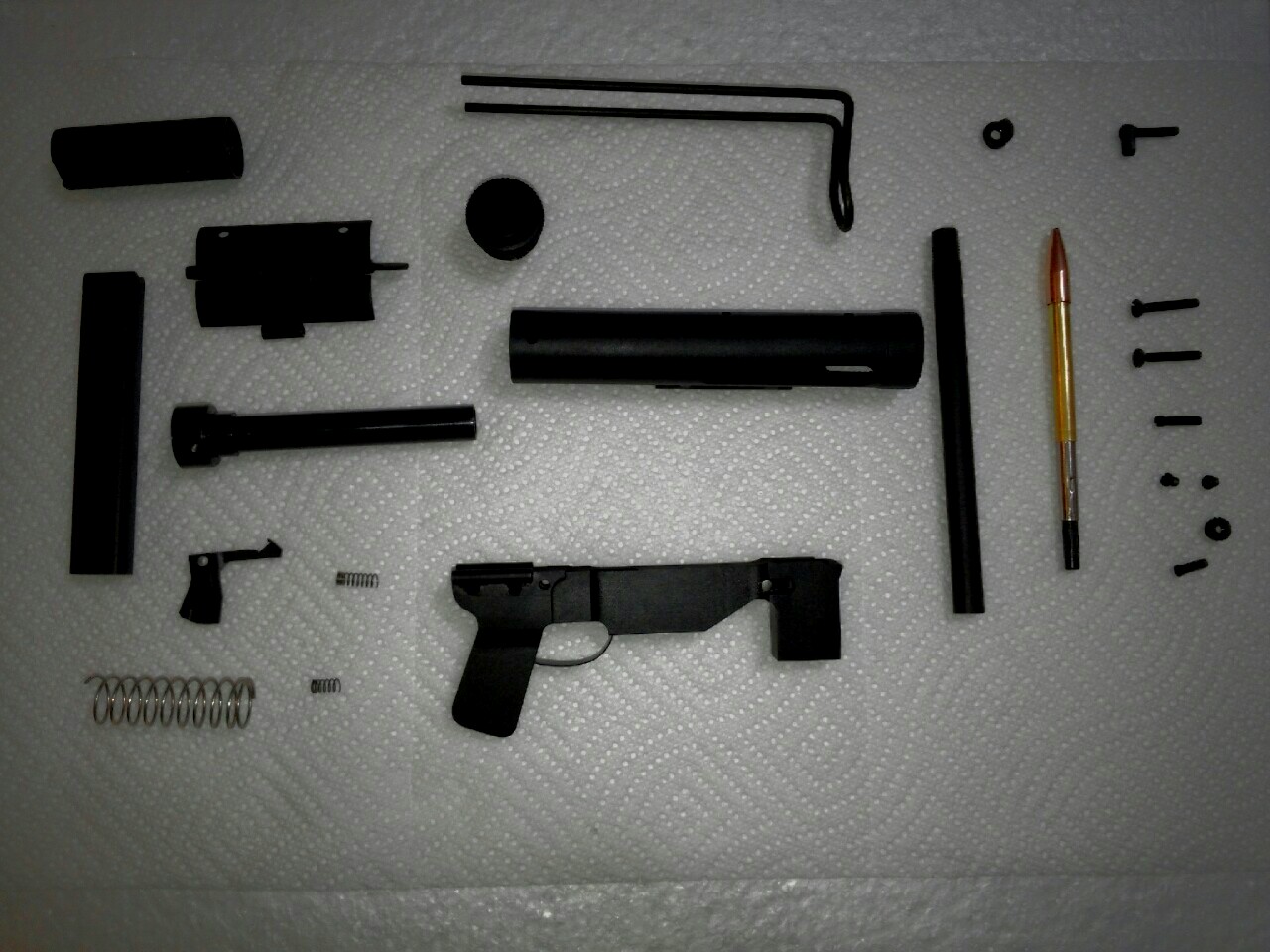

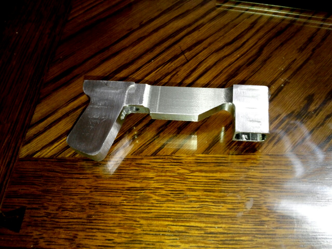

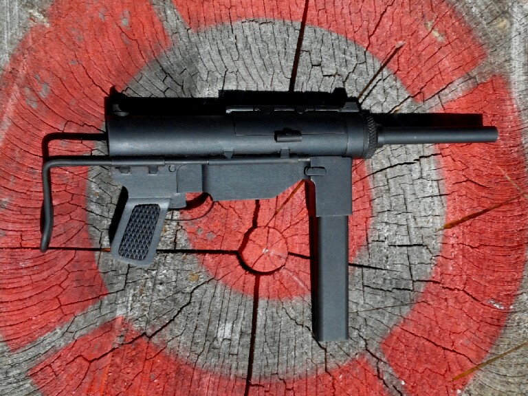

Hello all, its been a while since I posted one so here goes nothing. Here we have an M3A1 grease gun pen. Its made from steel, glass bead blasted and blued. the mechanism actually works, it is slamfire as the original when the trigger is pulled , mag and mag release are functional and actually cocks and releases the bolt when fired. I have an obscene amount of time in this one. Hope U like it>>>>>>>>>>>GEBC

On the home page in the Random Photos your pens come up now and then and invariably catch my eye. I always have a closer look. This is quite a stretch for a pen but a pure marvel of workmanship. Thanks for showing it. Did you start with some plans for a miniature replica and adapt them or develop it from scratch? Any others in a similar vein, like the Sten, down the road?
Apr 12, 2009
421
Chesapeake city Maryland

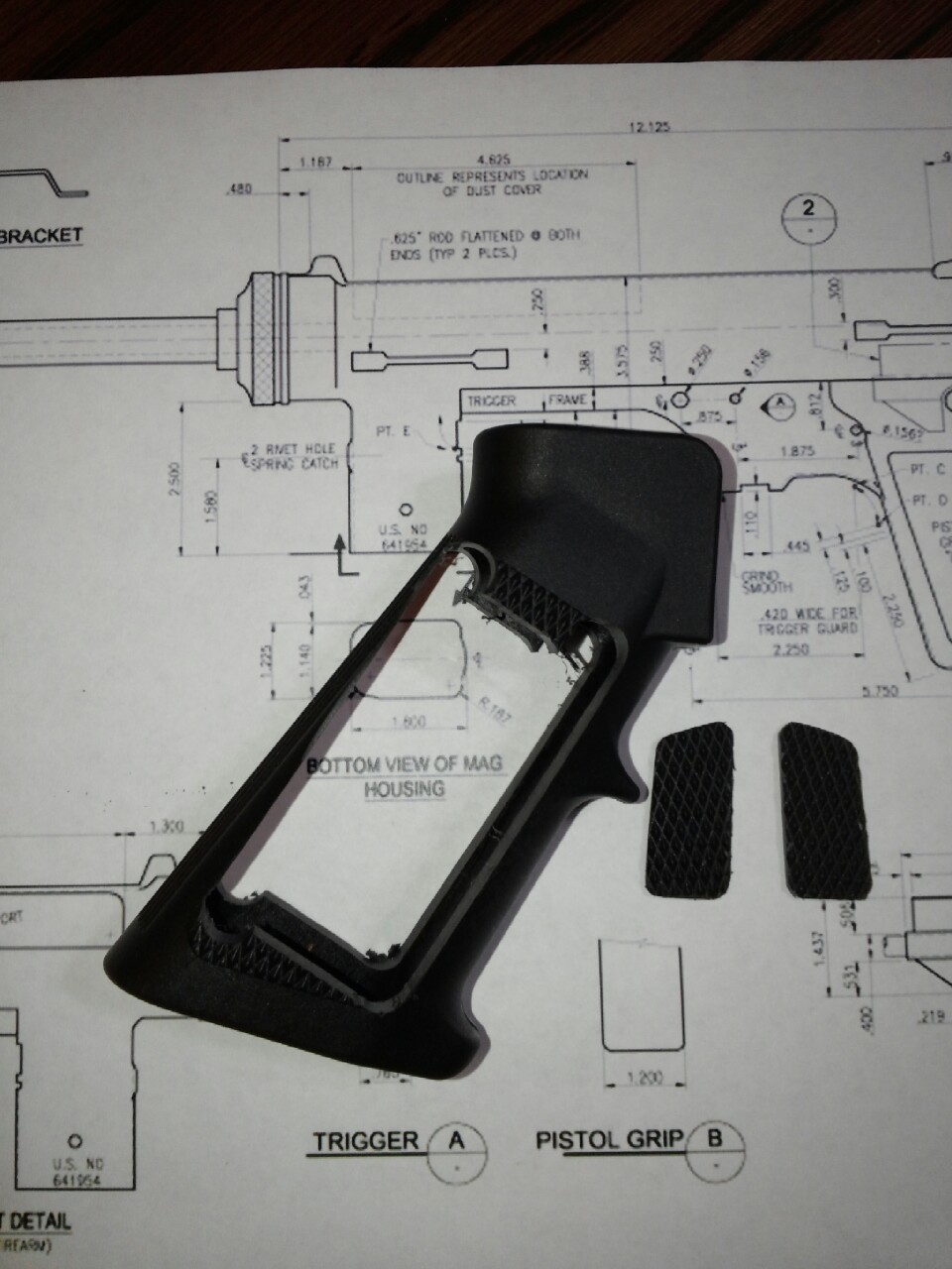

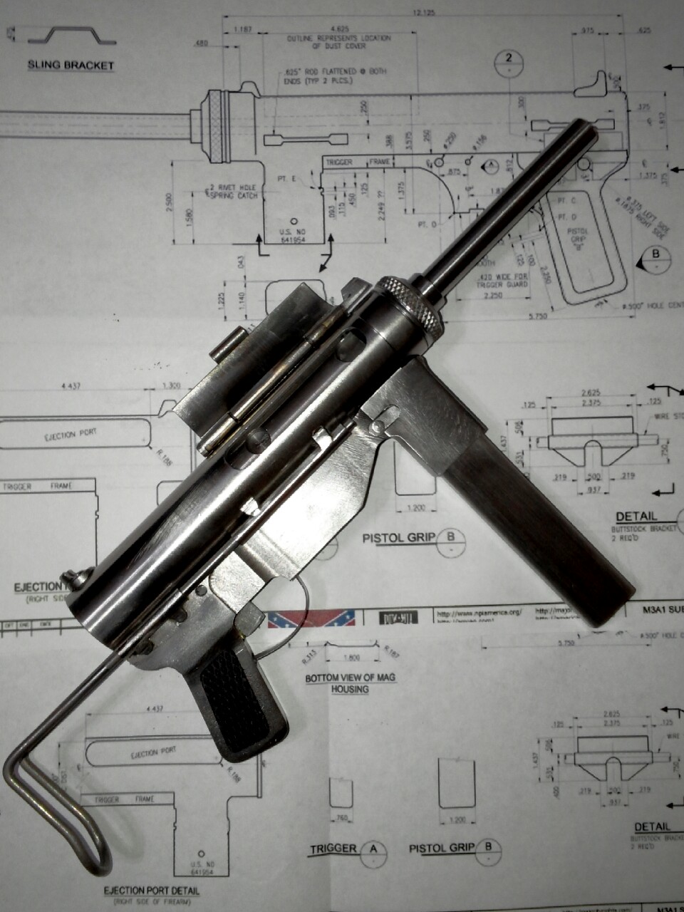

Thanks for the reply, I start with blueprints for the actual gun, I figure out how long the pen will be and scale everything down from there. Funny you mention the Sten, Michael's post earlier stirred up my interest in the Sten. Already planning to make one.
