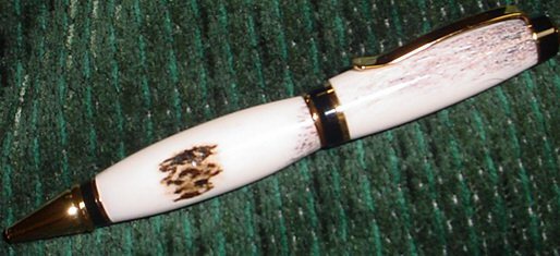

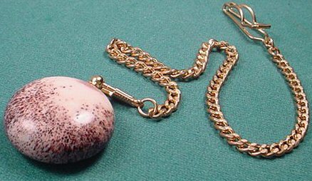

Ron:
Elk antler makes beutiful pens. The lousy pictures below don't do them justice, but show a couple I've made recently. The third pic shows a watch made from a flat spot on an atypical elk rack. for the pens, use the tines. Use the larger main beams for watches, duck or deer calls, pen boxes and the like. I fill the really open porous parts of the antler with medium CA. The porous part of elk antler shows alot of red and blue color when cut. IMHO Elk is much prettier than Whitetail deer antler.
<br />
<br />
<br />
Remember: If the great scientists and artists who have gone before us believed those who said it couldn't be done, we wouldn't have computers and this website. Why, we wouldn't even have pens or a way to turn them. Never be afraid to experiment.[:D]
