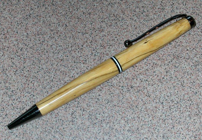

bjackman
Jul 13, 2004
506
Salt Lake City, Utah, USA.
Bill,
Here's one I did from my album. Seemed to have kindof a neat spiral grain. Creamy white wood.

bjackman
Jul 13, 2004
506
Thanks Bill.
It was very soft. I think I still have one more similar piece kicking around. It had sat out in the weather for about 2-4 yrs, so that's probably where the slight spalting on the spiral grain came from.
