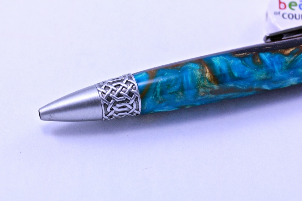

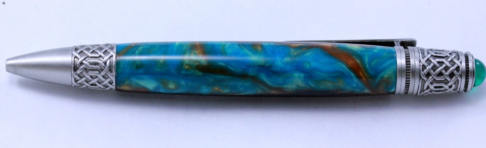

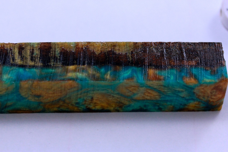

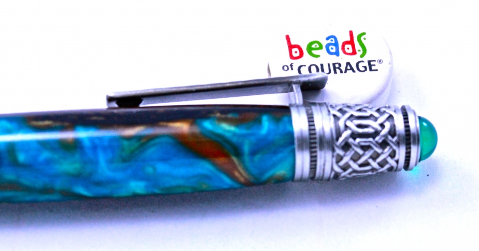

And here is some of George's (Robutacion) Shiraz Vine Cast Blanks!
