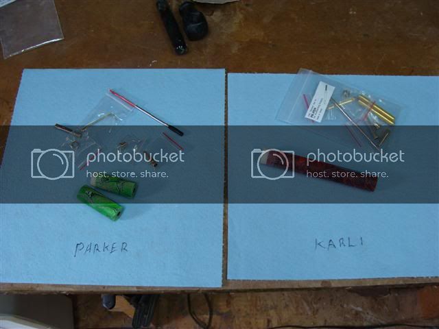

Here are their parts laid out with their names on paper towel
