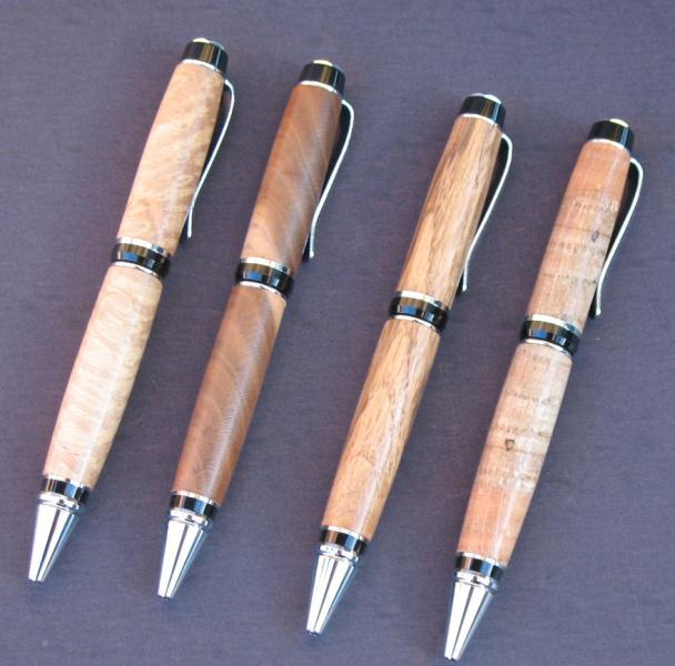

Wood used to make this pen comes with natural contrast I would not want to hide what nature provided. Scroll down to wildwood's comments.
http://www.forums.woodnet.net/ubbth...&Number=5676525&page=3&view=collapsed&sb=5&o=
These photos just an example of difficulty you face trying to glitter or leaf.
Spalted Poplar, Silk Tree, Oak, and Spalted Red Oak, blanks cut on diagonal except for Oak.
