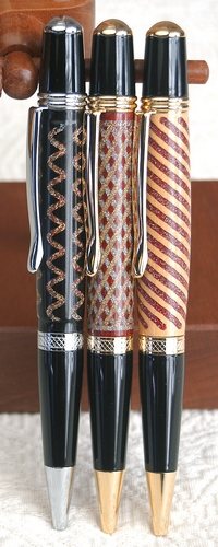

Just tried some inlay using 5 min epoxy and glitter. Got the large bottles of epoxy from a model airplane store and the glitter from Michaels. Seems to work really well and ready to turn in a couple of
hours. Faster than Inlace and cheaper. For black I have used ebony dust.

Holy Cow! Now thats a first post! I've been thinking about that same combination of materials (glitter and epoxy) for an inlay. However, my inlay plans were no-where near this!
I'm just stunned...each of those pens have incredible looks. The 2 pass gold/silver on the middle is just mindblowing.

Welcome, JR. Those are all beautiful. Can you tell me a bit about the process? Are you saying that you used 5 minute epoxy rather than casting them in PR?

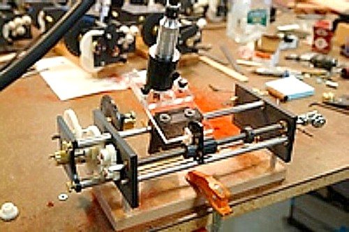

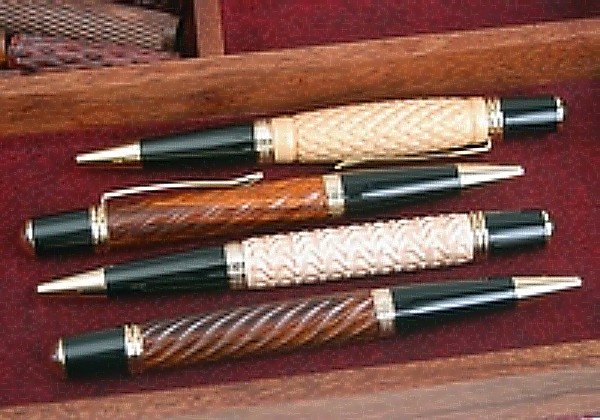

Thanks for all the kind comments. Here are a few more pens. They were all made on a new tool I have been working on. It is a much improved version of the Lathe Wizard but it is just for pens and is called the Pen Wizard. It is a stand alone device which holds a pen mandrel, right off the lathe and uses a Dremel or Foredom to apply ornamental patterns. It can do an endless variety of spirals, crosshatches and guiloche patterns with many types of router bits and end mills.
I have completed several prototypes and have sent one to China to see if can be manufactured at a price that will sell. If it works out, I expect you guys to all line up with money in your hands and make me rich.
Since I can only do one picture per post, I will make another post with a picture of the Pen Wizard prototype.
