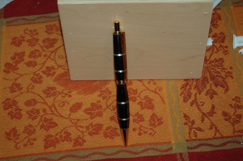

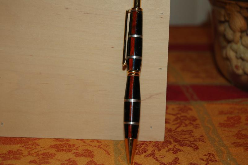

So the last pen I posted had a brass ring in it. I thought hey for my first time turning metal it went pretty well. This weekend I decided to get really crazy and go all out 4 count them 4 pieces of aluminum and 2 different types of wood. I went out a got some epoxy to put it all together and went in for the night to let it cure. This afternoon I go out to check things out and drill the blanks and try to make something that resembles a pen. I start drilling and the first half of the blank comes apart on my drill. I should have taken that as a sign (Put more epoxy or let it sit longer or something) But me being the Jarhead that I am I just figure a little CA and it will be good as new. The second half went no better. After some time a few glued fingers I finally get it on the lathe. while turning one of the blanks split, more CA. finally I get it turned to a half way decent shape and start to apply my CA finish. I ran out of my normal accelerator and had to use some of this new stuff I had never seen before. Well it worked, it made the glue heat up like crazy, burned the crap out of my fingers where I had glue I didn't know about. Finally after half a day on one pen I have a finished pen. She looks great from a ways away and you can't see all the imperfections.
